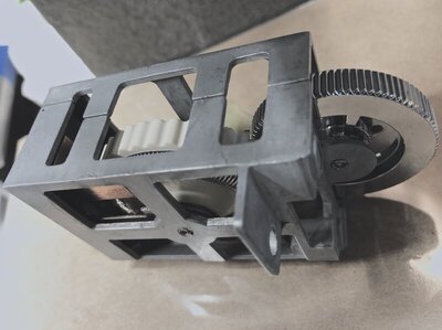

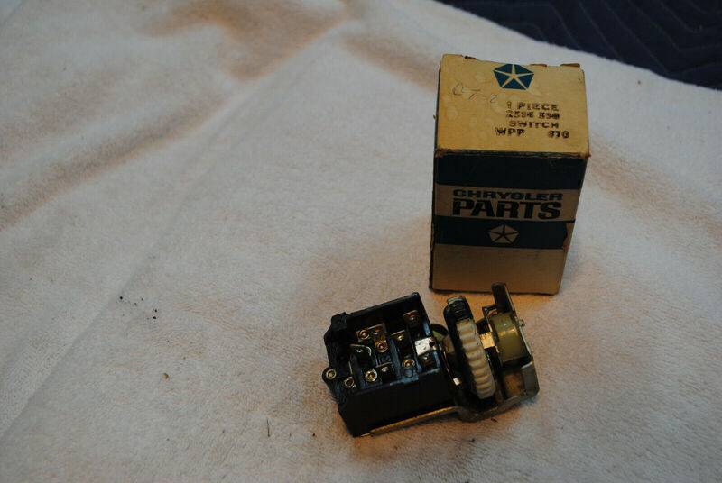

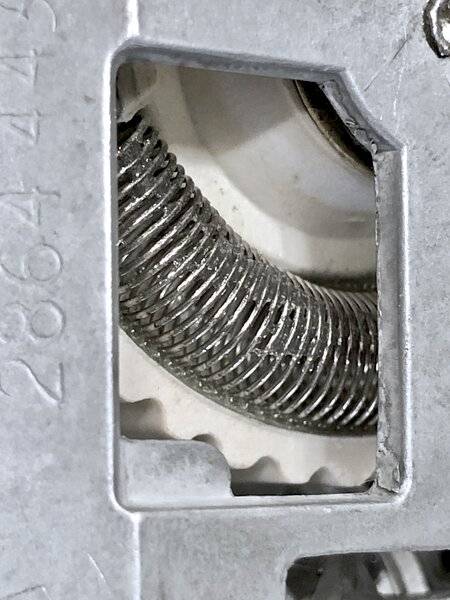

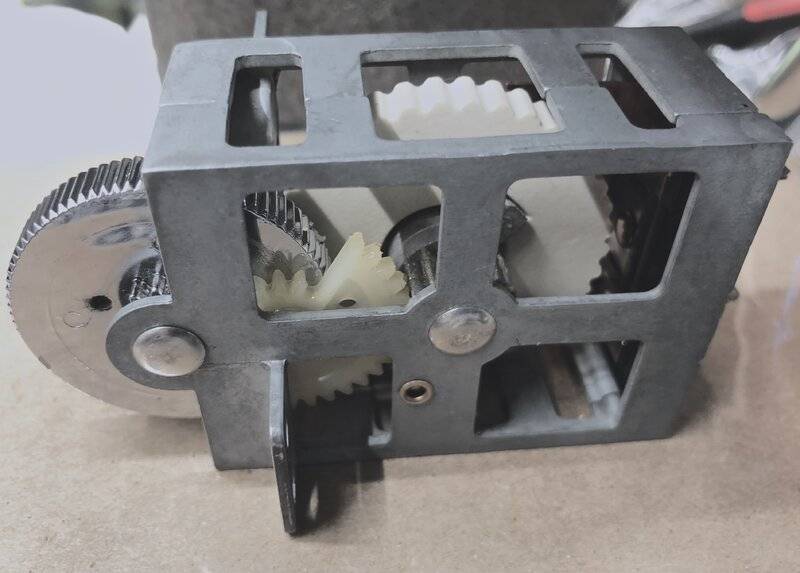

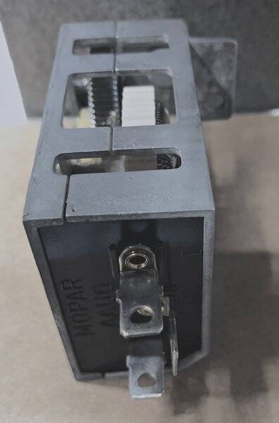

Your dimmer switch is an essential piece in the electrical system of your Mopar. If it has not been correctly restored, it WILL cause problems to include a burnt down car. The resistance wire gets very hot if the internal connections are not compressed well and the original potting compound that the wire is set in from the factory is brittle and WILL come apart. Please make sure that this component is in excellent working order. There are a couple of gauge and switch restoration specialist on here. I have done hundreds of these for customers. If you have questions, please ask.
ps: if you buy a repop chinese switch, expect it to not function consistently and accurately.
fullsizeoutput_6e1.jpeg fullsizeoutput_6e2.jpeg fullsizeoutput_6e3.jpeg fullsizeoutput_6c1.jpeg

Steve, understood. I'm going to pull my switch again to inspect. Looks like this..
