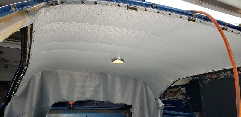

It’s been many years since I did a headliner and I can assure you, some of those were done with the windows in place. It’s not like the fabric wraps over the fence or anything. Just watch your fingers on those metal spikes!

I don’t think I’d bother with an “uphohstery guy”. One rainy afternoon in the garage and you’re done.

Optimal its better with all glass out. With that said you certainly can do it with the glass in place. This is not an easy job. It requires a procedure and patience to do it right. Lots of how to videos on the tube. I was taking my car to a higher level and optioned for a professional to do my headliner and vinyl top.
I have a 68 GTX and I think they're about the same? The headliner gets glued to the roof
all along the front and that gets covered by the windshield gasket. No way to do that
without taking the windshield out! The rear has gripper strips that you could probably
do without taking the glass out, but I would never attempt it. The rear window is easy
to take out & easy to put in. Also, while they're out, you can repair any rust.
Done it before & did it on my current car, without taking either glass out. I must be a freak of nature.
