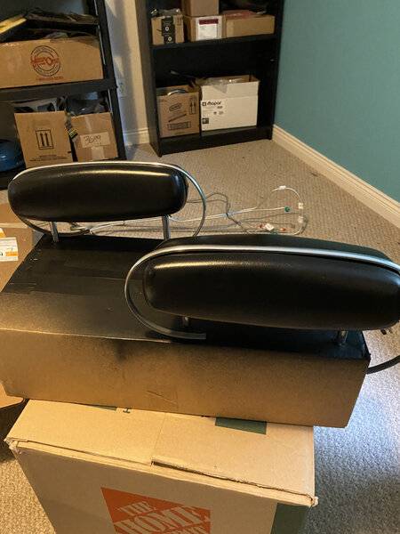

I cleaned up my headrests and bought new chrome strips for them but they’re not sticking. The headrests were cleaned then given 5-6 coats of SEM Trim Black and turned out beautiful.
Are there different qualities of chrome strip? I got mine of EBay for $22 but I see places like Classic and PG sell for $40-48.
My passenger side started to come off. What helped was changing the last 2" of double sided tape with an industrial strength one. Then I put a small drop of hot glue just a the ends and once on the headrest I cable tied it for a week. It stuck good now.
One of the big things is to get it to fit. You might have to use a heat gun to get it to fit tight. Get it fitting and the spring out of it and it will be easier to glue down.

i used the ones from classic ind. i was amazed how well they stuck when put on.
