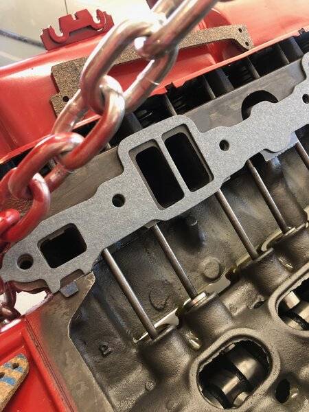

I'm installing an Edlebrock performer manifold, 318, and the fel-pro gaskets blocks the heat crossover passage, which is ok with me. But will that gasket hold up? Seems to me that gasket will blow out. Is there a good way to block the port, I saw someone weld it shut in the head, I see Edelbrock plugs that go into the intake manifold, but those seem to be for big blocks.
Suggestions?

I think FelPro still makes the blocked passage trays for a 383. Used those on my 440's for many years.
You can also just slide a small piece of stainless steel in there with the plain gasket. I've done that too with good success.
Yes, I have one, but would like to back it up, with the plugs. I would weld them closed, but the intake is already painted to match the engine...
It will burn through, as will any metal that's too thin(been there!). For your application--a 318 w/standard Performer intake-- I would just get gaskets that have the crossover ports open and save a lot of hassle...it won't hurt to let it work as designed.

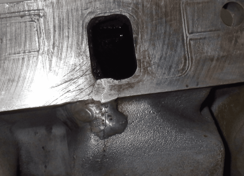

I recently plugged a cracked (failed repair) CH4B cross over with thicker plates cut out of a cheap grade stainless handy box cover......
Legrand® 430 Stainless Steel Blank Box-Mounted Wall Plate at Menards®
