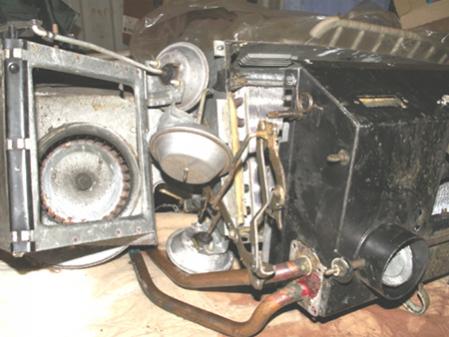

Ok i will dive back under there today, see what i can do. Same note though if anyone has a chance to take pictures of exactly what i need to do or see etc i'd really appreciate it I have a manual but its just about useless on this.
This is an A/C unit from a '68 B-Body. Note it has 3 vacuum units which control the air ducts. Hope this helps.
