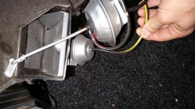

Did you paint all the parts after cleaning off the rust? If so, what paint did you use? Did yours look like this one before you started? View attachment 772652
AFAIConcerned it was bare steel for 50 years and barely rusted. I just wiped mine down with gun oil and it will be good until well after I'm dead!
I didn't have to fix the heater box, but it's made out of the exact same material as the Ramcharger air box and this works good and is even brown when cured... both the heater box and Ramcharger/Air Grabber hood boxes are dark Brown, not Black like most think.Great job on this!
Did you have bits of cracking or cracks to fix and if so what did you do?
Mine has a few that seem fairly minor but I'd say my box overall is pretty rough. Lots of screws had completely rusted out heads made it tough to get apart! The baffles seem fairly rough to.

Here is what I did. I put the outer case halves of mine in the bathtub, cleaned with soap and water first (after I gutted it). If that didn't get it clean, use something a little stronger. I then put mine in a blaster and adjusted, if need be adjusting the air pressure. I was fortunate enuf that my friend had crushed walnut shells to use. Then I put light coats of just some clear to get the desired look almost like original. I took all of the metal pieces apart, blasted them, and sprayed them with Rust-oleum silver. Then reassembled using new gaskets and heater core. I checked heater core for leaks even though it's new simply because I don't want to do it again. Even though no one will see it, I guess my OCD was satisfied.
