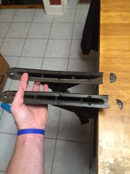

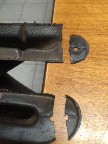

The mounting ear on my 67 GTX heater duct is broken, there is one broken off on each plastic duct....can anyone recommend a glue or epoxy to repair these mounting tabs or even a vendor that i can send these to get repaired...... i would even consider buying 2 new ones if anyone has a pair for sale... thank you Rich

thanks for the replies, i agree that most of the repair will be underside so it wont be seen, as you can see in the pics the plastic is very thin.... does JB weld make a product for plastic? i really need this to work cuz once i put this dash back in it will be impossible to get to if the repair fails

hey guys, really appreciate all the advice. i do have some of the more popular products mentioned above, heres my concern, what type of plastic am i dealing with on these ducts? all of the products say '' Does not adhere to polyethylene, polypropylene or some other plastics ''......... anyone know what these ducts are made of? will these products bond to my project ?
