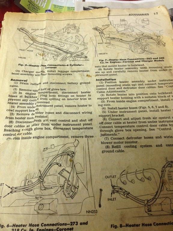

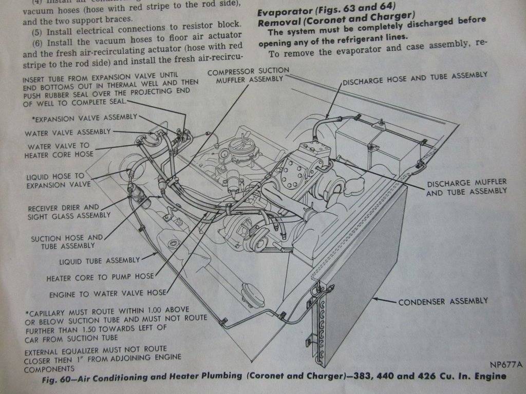

On a 383 engine, the outlets for heater hoses. Is there a suction side and discharge? This is important when I'm installing my classic air. The heater control valve opens and closes but i cant get heat in car. Was wondering if hoses were crossed. Thanks
The one furthest back and next to the water outlet to the rad is "OUT" and the one directly in front of it is "IN".
Here's a pic from 68FSM.
Here is a pic from the FSM for 69. It is for AC cars just in case there might be a question about connections at the firewall.
I always liked that they -include- the 426 Cu. In. engine in this illustration.:)
