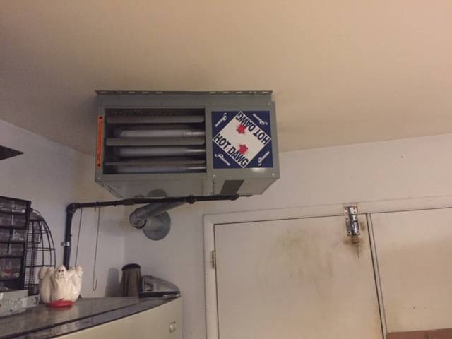

This natural gas heater heats my 22 X 32 garage and keeps it toasty.........

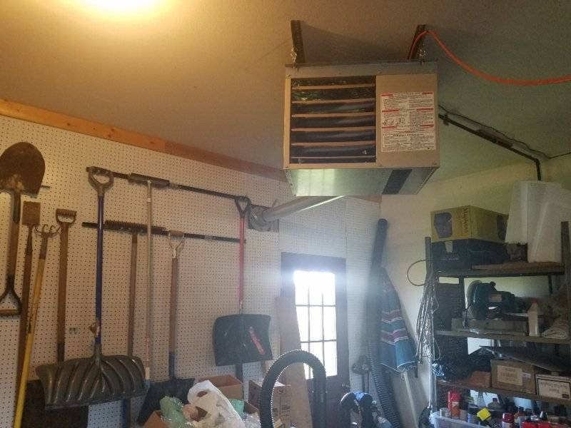

I installed a Lennox suspended gas heater in my three-car garage some 20 years ago and a few years ago finally insulated the garage with solid Styrofoam and peg board. Despite all this and hanging tools all over I got too much **** to get rid of. I had a capped gas line put in - in the basement when building the house figuring someday linking this to extend out to the garage through the wall. I found a deal on eBay for the slightly used heater at a great price and went and got that. It was a pain hanging it up as the ceiling is drywalled and crawling around in the loft above that had a portion of it floor-boarded so location of the mounts was a bit of a bitch. Then drilled out the rear wall for the vent. I never got to installing an outlet nearby so it's corded to the nearest ceiling outlet by the garage opener. Does the trick keeping the garage to what temp I want in dead of winter.
Here's a quick photo..

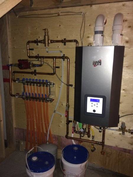

Before deciding on a boiler I was leaning towards a propane unit heater to maintain a constant 50 degrees then a woodburner for when I was actually in the garage. I called around and here in Ohio there were Insurance companies that would still cover it even with a woodburner so check first.

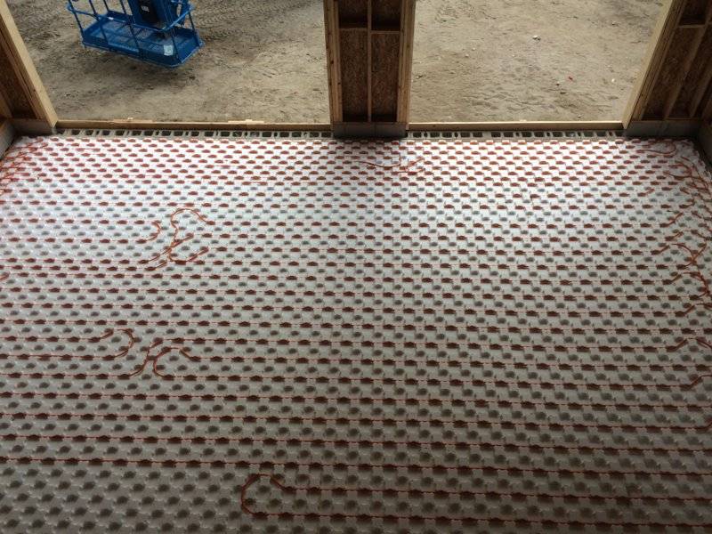

I put radiant floor heat in my shop when we built it 15 years ago and it was one my best ever decisions. Having the floors warm on a cold day is just the best. I had a friend come over today to work on his car. It was 40 degrees and foggy this morning which in the old days would've kept me from working in my unheated shop. But with the heated floors we just laid down on some carpet strips and starting rebuilding his front suspension. My last shop was unheated and it really limited the number of days per year that I could work on my projects. Once it got below 50 degrees it was just too painful to work for long periods of time. Handling cold metal tools for very long would suck enough heat out of my hands that I'd start to cramp up. Super miserable way to have fun! It is supposed to be a fun hobby not a torture session.
