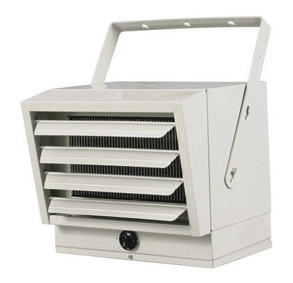

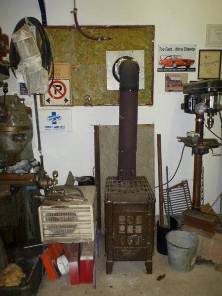

I run a 6kw x 220v heater to keep the shop at about 52F and have my grandmothers old parlor stove for when I really want heat. My shop has R52 in the ceiling and insulated Garaga doors.
We also have one of those wood burning heater in our pole barn it has a fan on the pipe to blow out the hot air. Works decent.

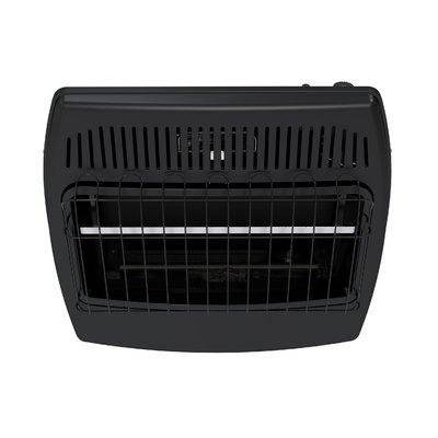

but the reviews are saying you must open a window or have a vent installed.
There are a lot of radiant heaters that catalyze the CO, but the vent is needed in many cases because of the humidity..... you need to let the vapors out, so your garage wont become a wet mess. I know some of you have loose garages, and your results may differ. Anyway, a lot of folks enjoy decent efficiency and good comfort from HotDawg style heaters. My favorite are the higher intensity long overhead tube heaters, if you have the cieling hgt to use one. Either should be vented though, and pull in outside air for combustion as well. HTH, Lefty71

My garage is a whole 2 car with insulated door and ceiling. I went with a Farenheat 7500 watt max (overkill) electric and very happy with it. No glowing coils, no flames, no fumes, and it's made the states.
Northern sells the 5000 watt.

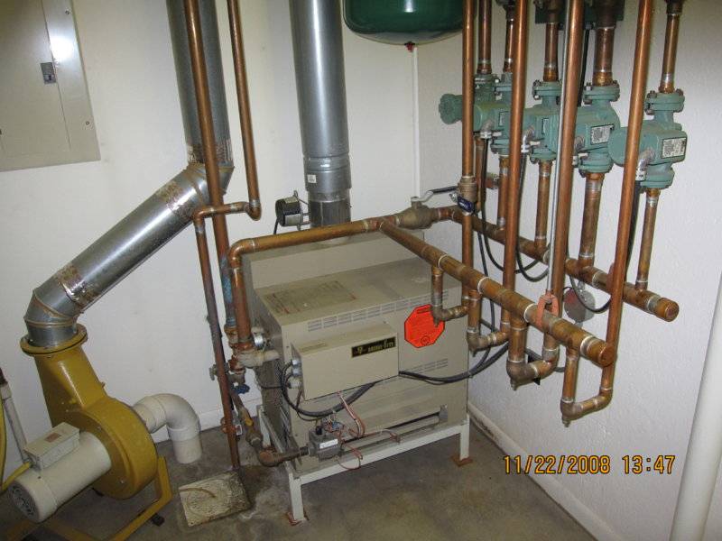

Propane heated water with 2 unit heaters, a ceiling mounted cabinet heater in the bathroom, and 6' of fin tube in the office.
