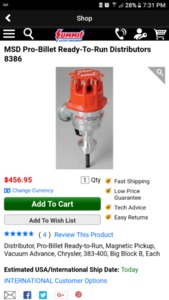

Thanks all for the input and help. I was looking at this MSD HEI that I included in a picture attached to this message. Anyome ever use this before?
why?
Damn I hate to see Chebby and Phord kind stuff on a Mopar engine bay... having Mopar kind options... or even aftermarket NON ANY BRAND RELATED kind options, such as MSD itself ( but not the HEI, maybe the RTR ).
for a simplier solution but keeping the look and pieces, Pertronix Ignitor. Just jump out the ballast on back ( inside the groove ) and done. I think is even cheaper.
that will keep your actual dist and no module needed, so will keep the stock 66 engine bay look. With several coil options from stock to performance ( oil, epoxy... Chromed, black, red )

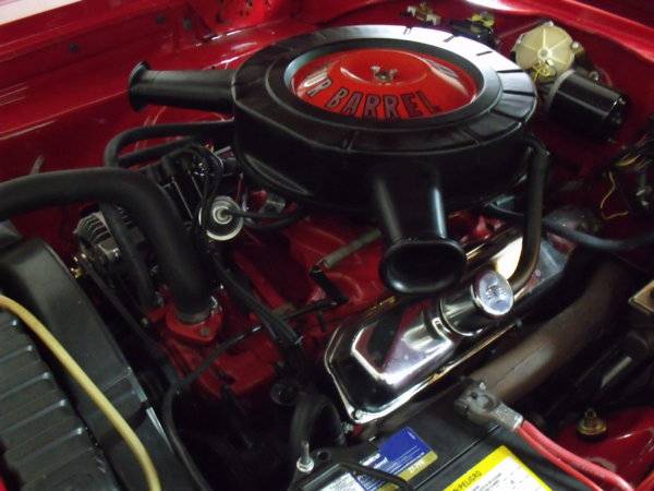

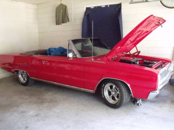

I put a Pertronix Plug and Play on the 67 Coronet I currently own... Billet, bearing instead of a bushing and NO boxes to deal with.. NO problems with it in 12 years...

In my current 440 car? Not sure, its about 12 years old. Plug and Play, black cap, billet housing, ...... I did have to grind down the stock 915 head a bit to get the distributor in.....
