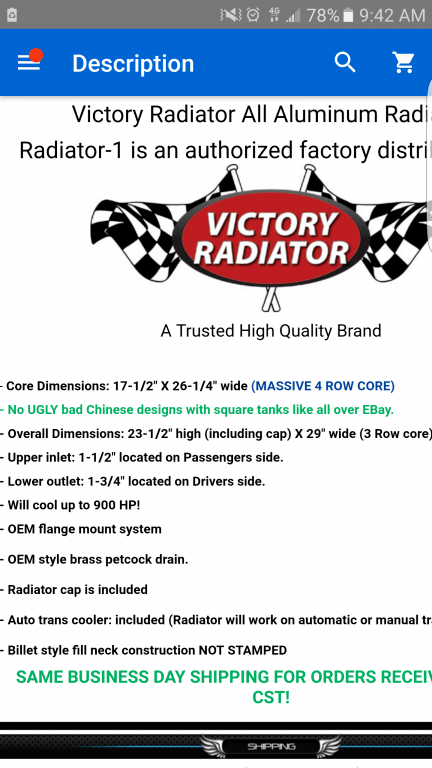

Would th fit?
2 row with 1" tubes and a fan/shroud will cool that just fine.

Can you link me to an exact fit radiator? I can't find a 3-4 row radiator that will fit my car with the inlet on passenger and drivers side outlet.
e-bay..search champion rad or champion coronet radiator.....
1967, big block 440, auto trans, 26. The only one they sell is a 2 row that fits.
I'll look BUT if like the last 3 I bought...the 2 row are two...one inch tubes which is the equivalent of a regular 4 row copper rad...and they cooled my 498 strokers fine..plus the current 472 hemi I have
