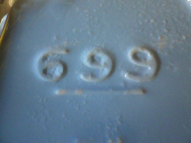

What are the large numbers stamped on your oil pan, on the bottom?

I believe my pan is a 187. Same setup as you otherwise. Originally a Satellite with small block. I bought the car with the 440 installed already. The front of the pan was hammered some toward the rear to clear the frame. I don't know what was done on the pickup. The guys at 440source told me the pan is for an A body with a 440 like the 69 Darts and Cudas. If it were up to me, instead of beating up on the pan, I would have cut the rear of K frame and reinforced it to make room. By the way, mine is a 1973 also with a 68 motor. Good luck!
699 on mine , 74 charger 440. Zero modifications bolt on and go

Yep a 971 pan is what came on BB in 73-4. 933 is a C-body pan and doesn't fit in the 73-4 B-body. Best bet is the MP pan list above.
Also the 187 and 699 are C-body pans but work for a BB in an A-body. BB A-bodies came with a 893 pan from the factory.
