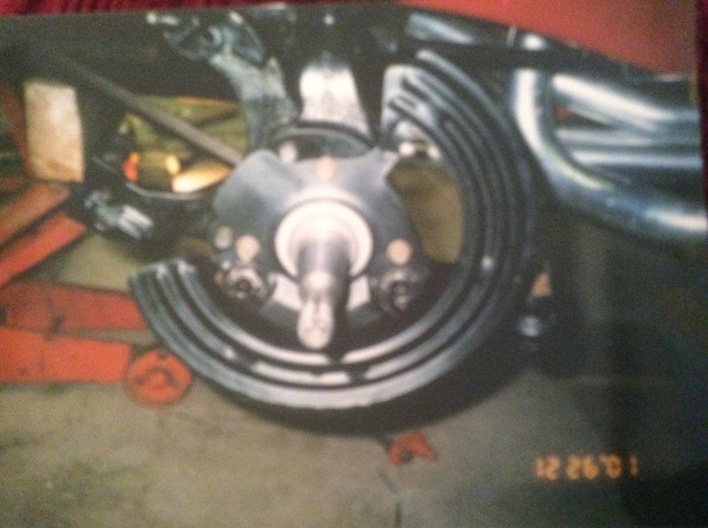

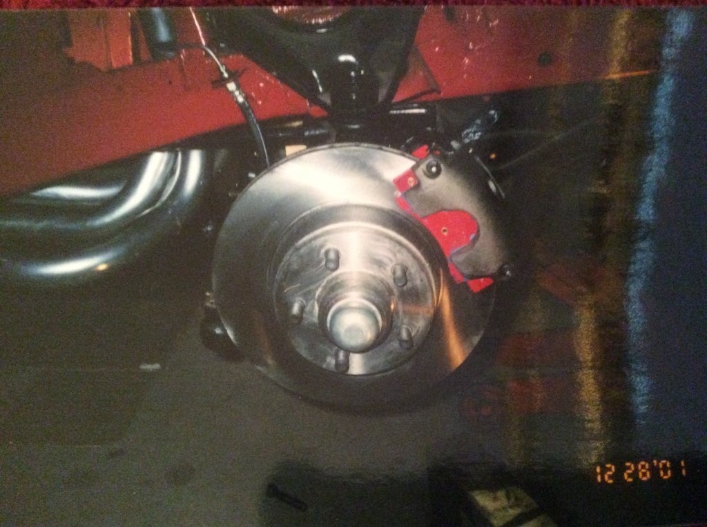

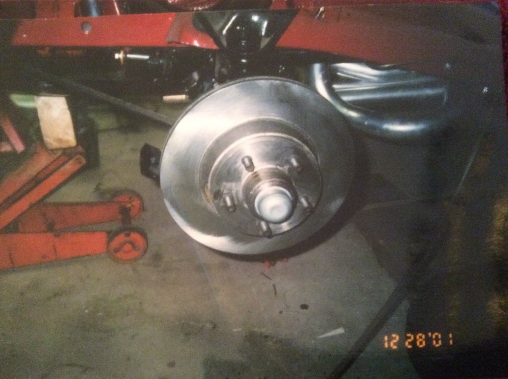

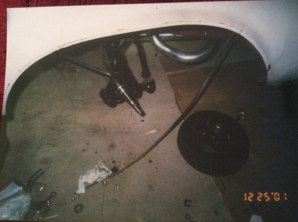

I did a drum to disc conversion in 2001 $560 ish. Mostly new parts, used spindles and caliper adapters. It was the conversion in Mopar Action mag. 11.75 rotors and slider calipers. Sent a picture to a mopar junk yard with a picture of the caliper adapters for both sized sliders and marked pictures so I didn't get wrong ones for smaller rotors. They cost me $90 then. On ebay when you see them $200. I'd do like I did send pic's to a junk yard. I don't know if I can find the article. If your interest
ed I'd look. There are another type of Caliper adapter that are more common I'm not up to speed what they came from. There are a ton of threads about this you should search for drum to disc in the search box.

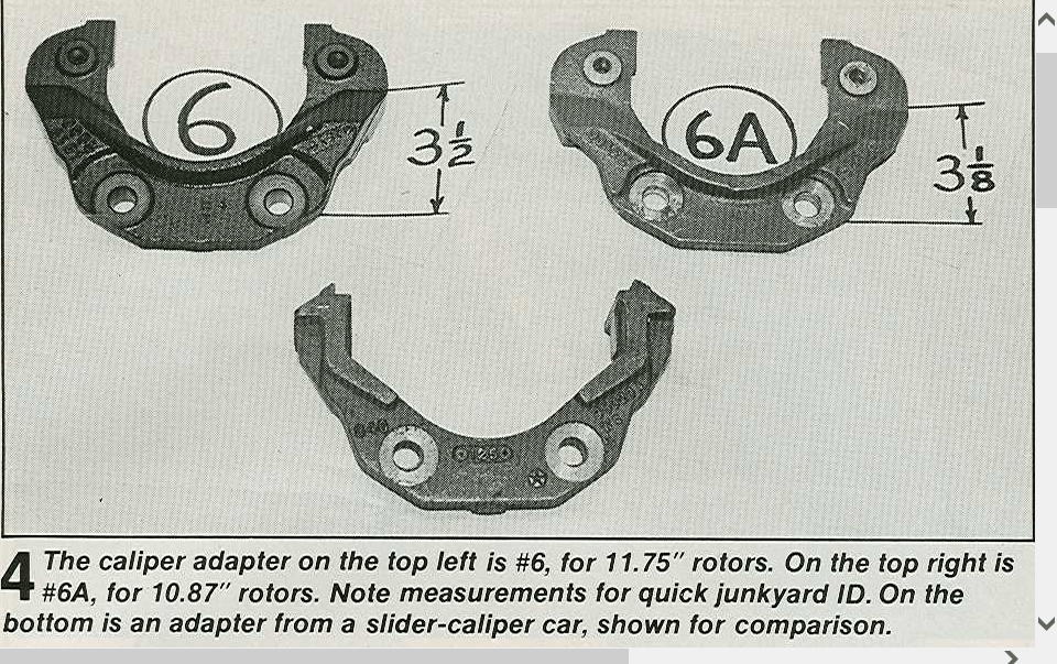

These are the two caliper adapters. I bought my adapters
from a junkyard in I think in Minnesota. I sent this picture to them with the one I wanted circled. 10 days later got them. Forgot I have a disc with Mopar Action Tech articles. These are the one part I think you need pictures for part numbers won't do.
NEEDED
#6 Caliper adapters two p/n 3880557, 1976-78 B-body pin-type calipers for 11.75 Cordoba rotors.
