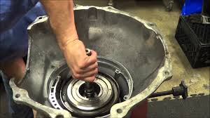

Is the torque converter seated fully into the trans? When the trans is bolted to the block you should be able to spin the converter easily before you bolt it to the flex plate. If not that "crang" you heard could be something really ugly to fix.
The noise from the font timing cover is really odd too ... almost like the CAM slid (or was pushed) forward and the timing chain is grinding against it.
When you are putting the trans up to the motor, it sounds like you didn't get the converter all the way into the trans front pump. there are two slots in the converter snout that engage the trans front pump. When putting the converter into the trans you need to rotate the converter while pushing lightly backward until you get a "clunk" and the converter slides back 3/4". With the trans bolted to the block, you should be able to rotate the converter freely. Hopefully you marked the converter and flex plate both in the correct position, one of the bolt holes is offset. I always put the flex up to the converter where I can see them, line up all the bolt holes and give a shot of paint on the engine side of the flex and converter by one of the bolts so you can see it when you go to bolt the converter to flex. You can get up to three bolts lined up & not the fourth. Then you need to remove the converter to flex bolts & do trial & error until they all line up. Hope the loud metal "crang" wasn't the drive tang in the trans front pump breaking. When you say the scraping sound is coming from the "timing cover", you mean the front of the motor? When the motor won't turn I suspect you've not got the converter all the way into the trans. As you slide the converter back into the trans and turn it there is a very distinct "thud" and movement of the converter back into the trans. Good luck. BTW most of us have made that mistake!

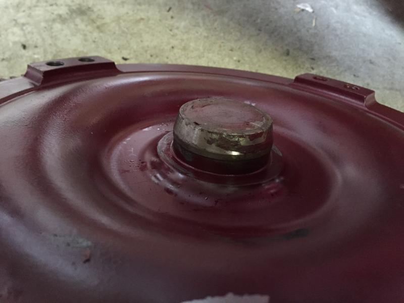

The male piece in the converter that slips in the crank worries me, it seams like it might be too big? Speculation though.

The lug at the front of the converter is for centering with the crank. Yeah, it should slip in easily.
You stab the converter into the trans first. Yeah, it will sit there. You can reach in to the trans front pump, and turn the drive dogs to line them how you want. Then stab the converter into the trans, making sure the slots line up with the dogs.

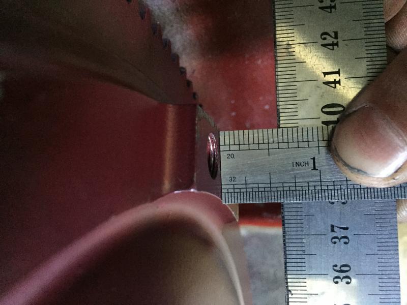

Then, you stab the trans to the motor. With the trans case bolted to the engine block, you should have a 1/4" space between the converter, and flexplate, and converter should simply push forward to close the gap.

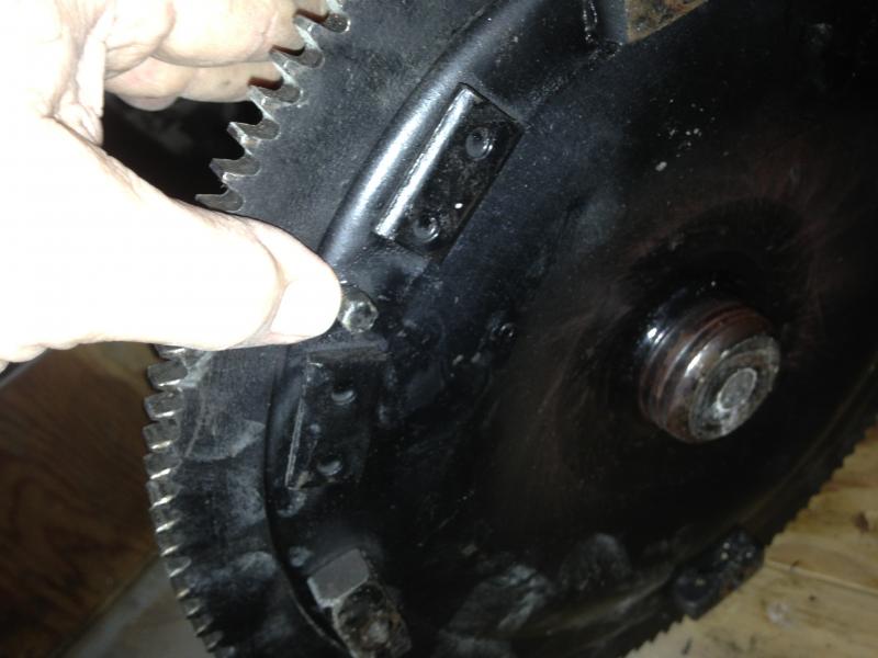

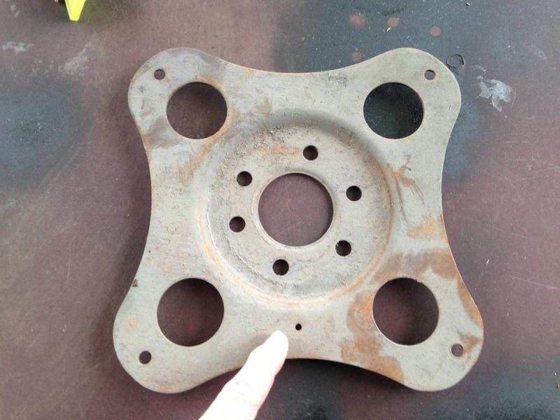

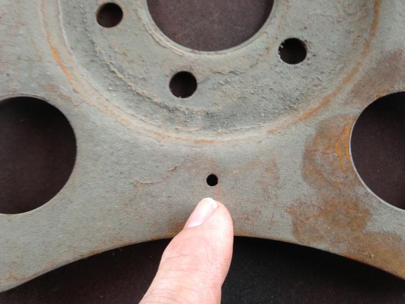

On some stock factory flex plate there will be a small hole located in between two of the crankshaft mounting holes. This hole will be about 1/8" in diameter. This was used to index the converter. The drain plug on the converter would go 180 degrees opposite of the small hole I mentioned. This allows the converter bolts to properly line up to the flex plate since they are offset. Then you can mark it however you please.
As far as the engine problem I would suspect the thrust bearing may be your culprit. I have seen several engines run with a lot of excess side play clearance that allowed the crankshaft to move forward and back. One engine had almost 1/4 inch of excess end play and still didn't make a noise !!!!!
Hope this helps.

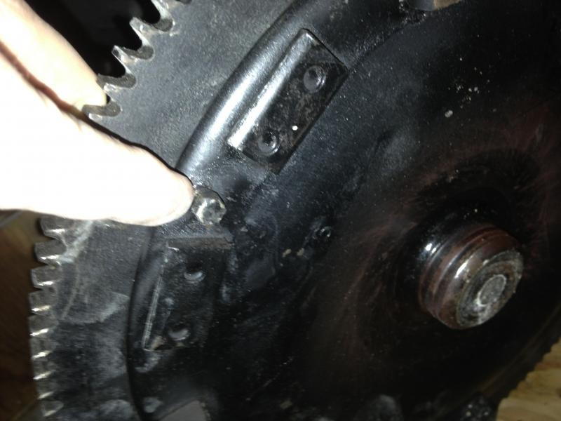

Here is a picture of the hole in the factory flex plate I mentioned above. This hole goes just opposite of the drain plug on the converter.
As you can see from the picture it's not in between two of the crankshaft mounting bolts like I originally posted. Sorry for any confusion.
In the last two pictures I'm showing you what the drain plug will look like on most converters. Hope it helps.

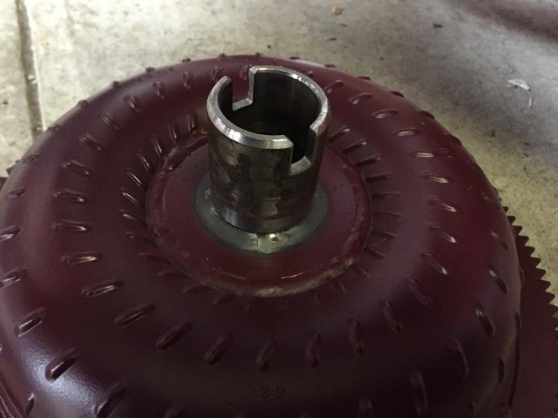

Thanks guys. I am mounting the converter to the tans first then lining up and installing the auto onto the engine. It is engaging both splines and is in as far as the FSM suggests. On a side note my converter doesn't have a drain plug.

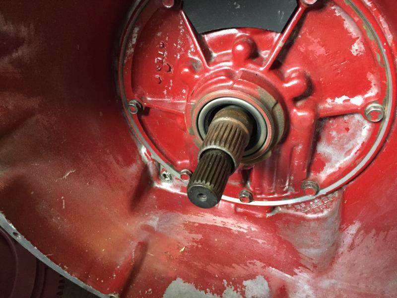

Here's some pics:
I have run a screw driver around the trans spline and there are no notces for the two cut outs on the converter to line up to. I'm a bit worried that this might not be the right converter?

Also I should mention, every time I have mounted the trans I have not been able to spin the converter. It has always been pressed up to the flexplate tight enough that I can't spin it even through it has been engaged on both splines. Previously it would rotat with the engine when spun by hand, obviously the last time it seized the engine so that is different.
The two tangs for the front pump are not very visible because of the front seal where the converter slides in. You can be engaged in the two sets of splines you can see but not be in all the way. Slide the converter on to both sets of splines then rotate the converter with a small amount of push toward the trans and wiggling it a bit. Keep doing that slowly until you feel the converter pop back further in. The .5 inches is not nearly enough to be in all the way. It sure looks like a Mopar converter & they're all the same except the diameter. Yours looks like a 10"? The hub that goes into the crank is almost certainly the correct size. You just don't have the converter all the way home in the trans.
So the trans is fkd. Pulled the front deal and found two sheered teeth that the converter would have engaged. I was sure when I first installed it that it had nothing to engage. So I may have got it that way, however it's just as likely I did it.

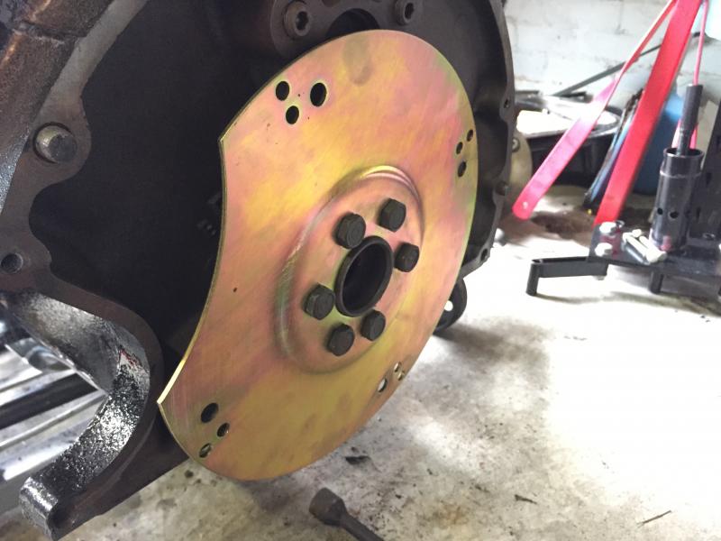

Are you running a "Cast" crank ???? If so, your converter should have two fairly good sized weights on it.
It looks like you have a cast crank flex plate.
These engines are externally balanced.

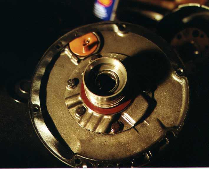

Here are a few pictures I found online showing the pump and what's behind it. They have a book out on how to rebuild a Torque flight. If your serious about doing it yourself, I would get the book.

I've got a cast crank, brought an external balance fly wheel. Do I still need a converter with balance weights? I haven't seen any of those before in my internet searching...

Don't rush it, check to see if somebody with experience can help. If you mean flex plate not "fly wheel" , it looks like you've got the right part. The "half moon" cutout in the full circle flex plate is probably the "converter balance weight". I haven't seen one like that for many years, but I think that's how B&M addressed the cast crank balance instead of on the converter like the factory did.
