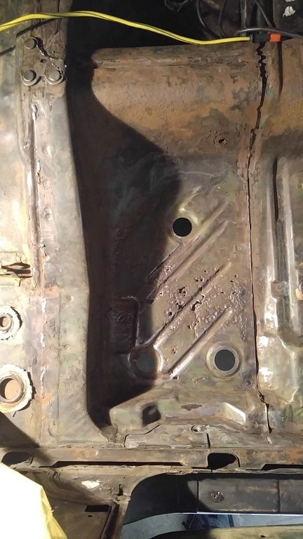

Well, I have decided to do this correctly and have ordered a new floor pan patch panel for my 72 Satellite. I am new to body work and I hope someone can help with a couple quick questions.

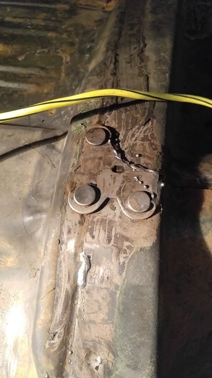

1. What is this this little bracket with what looks like 3 rivets, and how the heck do I get it out?
2. What is the best type of wheel to use with an angle grinder to cut out the tack welds without messing up the adjacent panels?
3. What is the best tool to remove the plug welds?
Thanks!

1: Not sure, is it bolted from underneath?

They look more like pins than bolts, and the driveline is still in there so I don't know how much I can see underneath. I will crawl under there and see if it is visible.

I got thinking, I wonder if there is some form of vibration dampener hanging under that plate?

That plate is interesting, doesnt look stock. Is it right over the driveshaft tunnel? Just look underneath and see what it goes to.

Thanks, I will definitely check out that Blair. Yes, the plate is on the middle of the tunnel, where the rear floor pans meet the pan under the rear seat. I will try to get a look at the underside tonight.

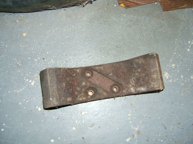

is the a large piece of steel/cast iron bolted to that bracket under the floor ?
there should be,unless someone took it off

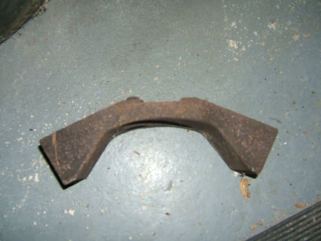

its the mount for the vibration damper that is found only on small block cars
here is what you should find or find missing..
a hunk of metal
Oh my lord, that looks like it will be tough to remove with the driveshaft in the way. :( Thanks for letting me know what I am up against.
i don't know for sure,
but i would venture to guess that you will have to drop the shaft to be able to get to it.
its not light either.
Sinice the existing pan is in good shape in that area, I might trim the new pan and butt weld it around that monstrosity. I know a guy that can TIG it for me.
