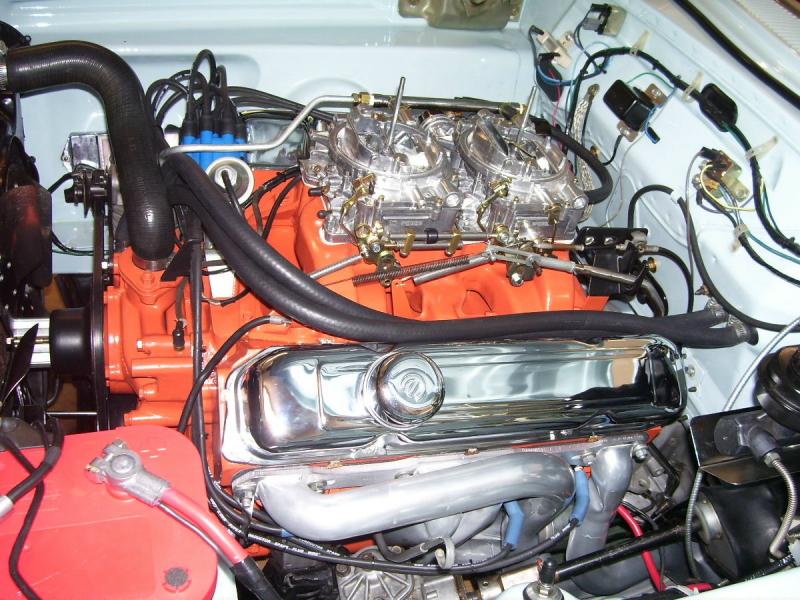

i thought the factory manifolds had 1 7/16" and 1 9/16" bores,....? i know they used pretty small carbs. this set-up in the pic is a nice reliable package.

not sure I made myself clear. the intake is a stock 413 cast iron, so the carbs wont work?
The primary bores on the stock 2/4bll. manifold measure 1.560. (1 9/16) The secondary bores are 1.680 (1 11/16). The primary bores are too small for a 750 cfm carter which measures 1.680 (1 11/16) primary and secondary.
The 600 cfm carb has a smaller primary of 1.430 (1 7/16) and 1.680 (1 11/16) secondary, that will work but you need 1" spacers under them for linkage clearance.
Hope this helps...
You can have the primary bores opened up, if yours havent already been but the money to do that would be better spent toward a good aluminum one like lewtot has...
