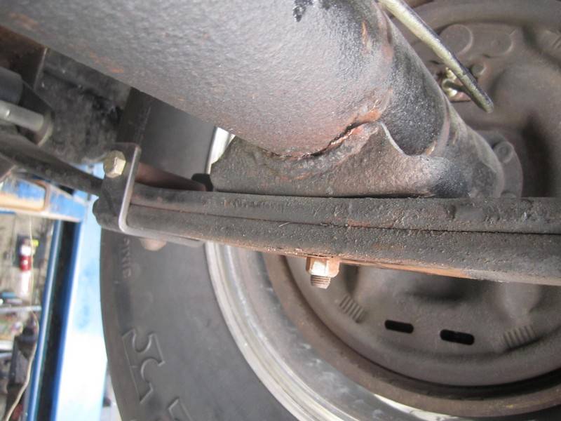

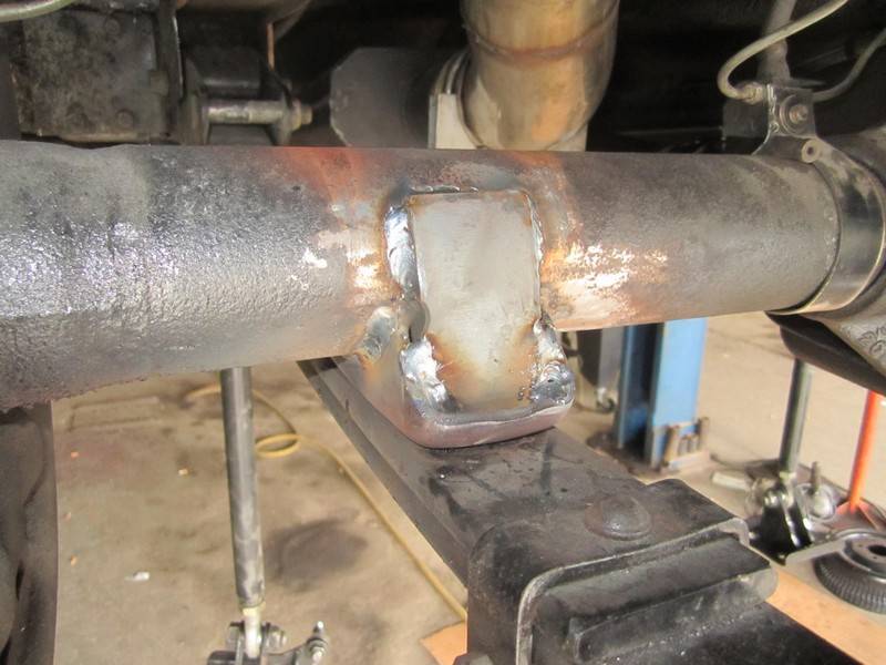

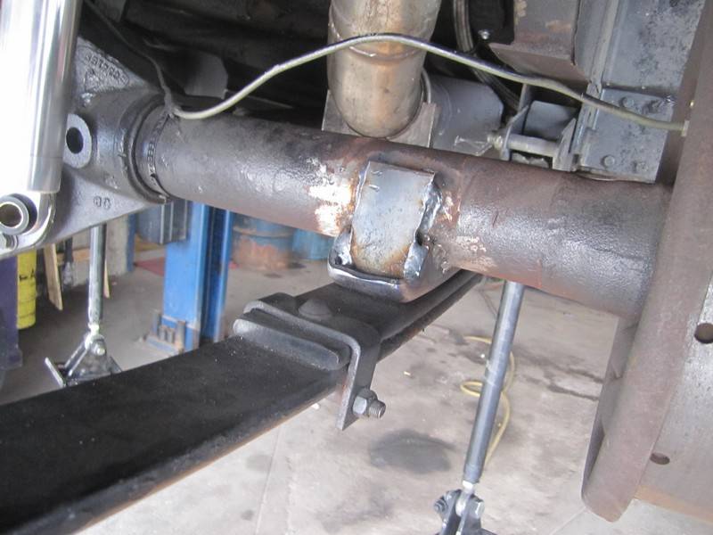

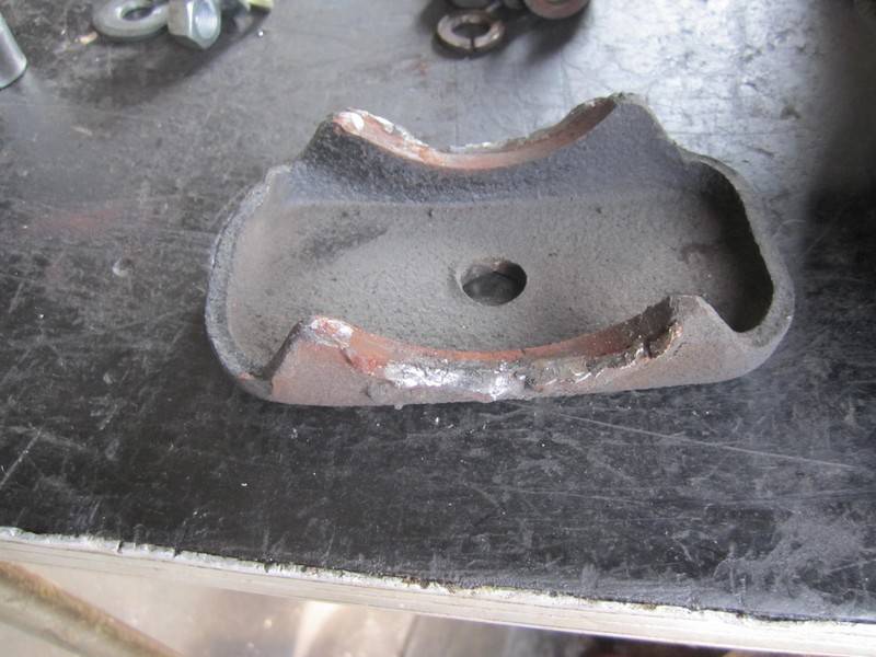

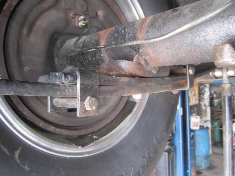

Thank you, I was confused because I clearly looked at both pins heads and it surely didn’t look like the holes are bigger than the heads. It looks like the heads are actually pulling down on the flat sections of the axle perch ? Maybe, they are just shifted enough making it appear that way or there is a lot of rust and dirt inside the holes making it appear that way ? So, if I jack the axle up enough, with the cars frame on jack stands, the pins should pull through the axle perch holes ?

The spring perch has an alignment hole,it is not bolted. UNbolt the U and jack the diff up for access.
