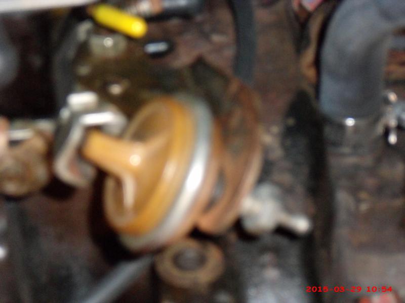

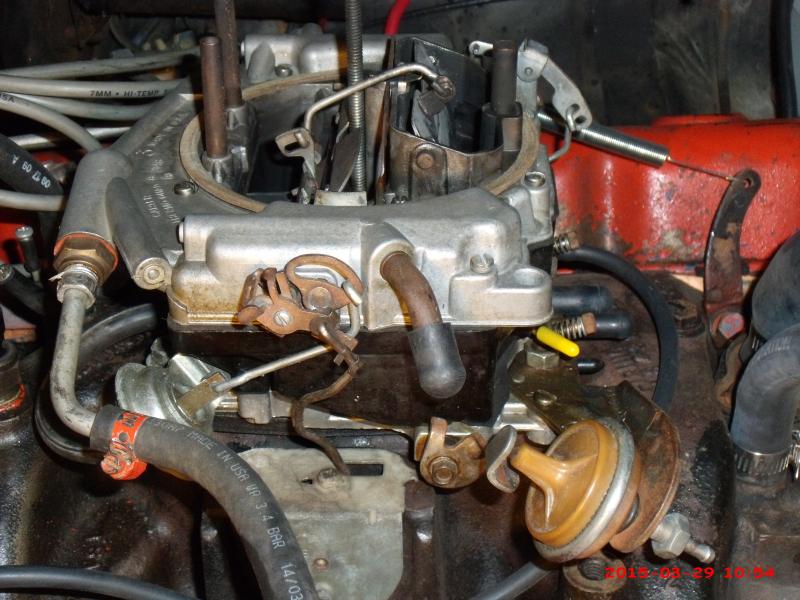

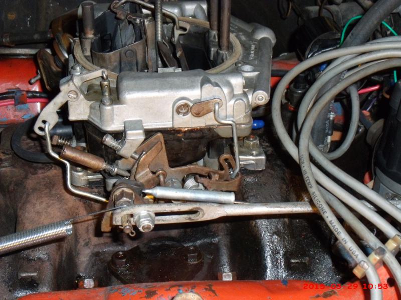

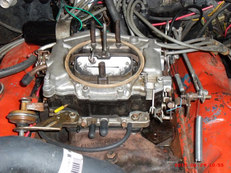

Problem seems to be resolved. I did try all of the suggestions from everyone. Some had minimal effect. The issue proved to be a weird vacuum actuated pot on the right front of the carb (see pics). We timed her as close as we dared, readjusted the idle screws and started disconnecting the throttle cable, minimal effect, the kick down linkage, didn't seem to have any effect, went after the various vacuum ports that were capped off. Hit on whatever this thing is and the RPMs plummeted! I couldn't see it but, it was definitely holding the primaries open just a bit. I pulled the vacuum line off and threaded the pot away from the linkage. i still have to nudge the gas pedal from underneath to get the RPMs down all the way so, I think a throttle cable is still in the future as well as a carb rebuild but, she will finally settle down to about 700 RPMs. It's been a lot of frustration and work but, 850 cfm's of Carter TQ is all worth it. Thanks to everyone again. Your thoughts and suggestions got me moving the right direction. For reference, if anybody is curious, this is a
