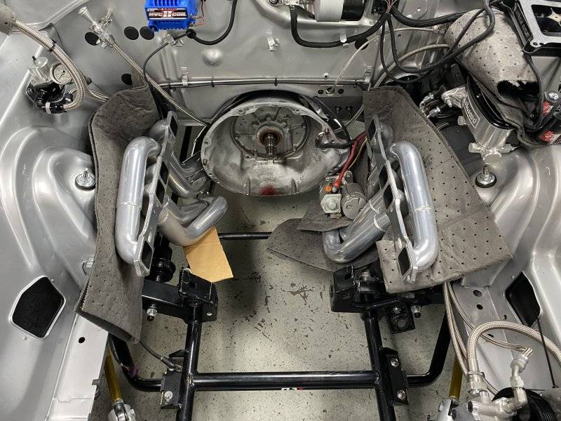

Sure, it appears there is some run out on the ring gear.
“If” the converter were balanced, that would be accounted for during the balancing.
The converter itself “should be” running true to the crank, since the hub on the converter should be located by register at the back of the crank.
Speaking of the converter.......have you done a high gear roll on stall check to see what the stall is?
