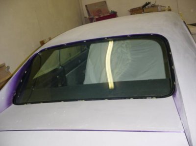

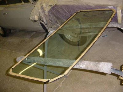

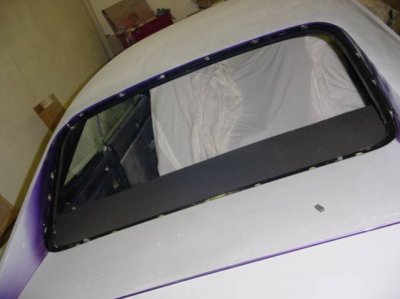

I did mine myself but have had years of experience in restoration. Remember this very important part of this installation if you are doing it yourself. Make sure your pinch weld around the window is clean and don`t forget to apply the pinchweld primer and completely cover the flat of the pinchweld or your butyl kit will not stick properly. Also install all your window clips BEFORE you install your glass. I didn`t have the original stop blocks on the bottom so i used two pieces of hard rubber that was 3/8 " thick & 1 1/2" long. Stood them up at the bottom to put the glass in and offer a guide and then turned them down & left them there, so the window will not settle when the car is in the sun. You can see one block laying on the dutchmen panel just before i put the window in.
