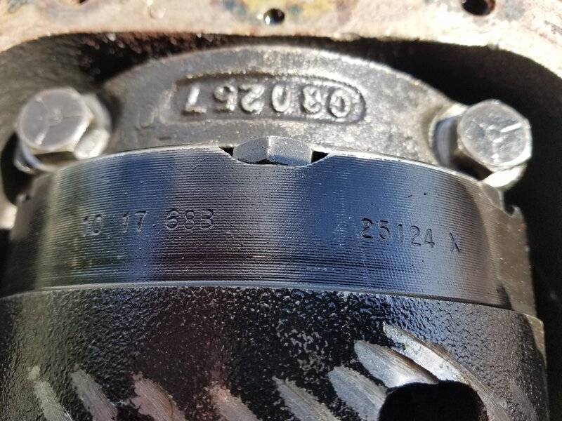

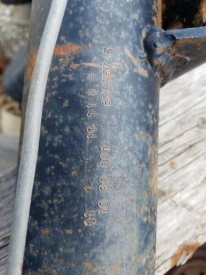

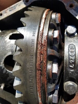

I have this Dana and would like to know more about it. It came with a Belvedere 1, that I bought.
Thanks Gregg
Resized_20200520_143646_6004.jpeg Resized_20200610_163708_3922.jpeg View attachment 961732 Resized_20200610_163633_386.jpeg
Thanks for the help, anyway to tell what B-body car it came from? I dont think it will fit my Belvedere without moving the spring perches. I wonder if they blew up the
4:10s and put 4:88s in it. The carrier has some grooves it from the gear set.
The spring perches will be the same at 44". The overall width will be wider by 5/8 to 3/4".
Well the spring perches measure 35in. center to center. They must have been moved in? The housing measures 54 1/2 width and has 11 in. backing plates.
