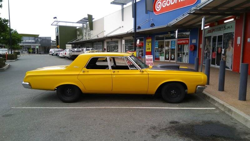

Me?? I'd say, you already have the 360. You could get very serious with that if you are'nt bothered by spending $11K. Along those lines, anyone could build a nice 451 for $11k as well. Since the car is already set up for small block, I'd probably stay there. The 383, forget it. You are'nt going to get into the 11's as easily and the 6bbl won't likely help you (over a single 4bbl.). You are definately gonna need some of that budget money spent on the chassie to accomplish your goals, which makes it even more important to stick with what you have and not blow half or all your wad on another whole engine. HTH, Lefty71
