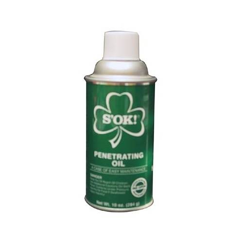

I like s'ok, that stuff has been around for years and always worked for me...
