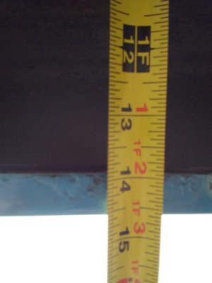

      Sorry, I thought I mentioned it earlier. My bad, I did not proof read. I have 3/4" difference between the left & right side. The weheel fits fine on the Passenger side. The left side was backed into a couple of years ago, but I think it looks straight. I'm visiting the repair shop Monday to have him look at it. Not sure what else to do in this regard. I can return the wheels to my friend who sold them to me, no trouble there. It's just a good deal, and I'm helping to finance his restoration of a Rare convertible E-Body. If I can resolve the issue and keep the wheels, that would be my preference, but thankfully not my only option.

        Here's the difference
