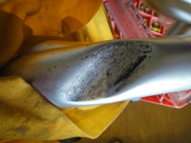

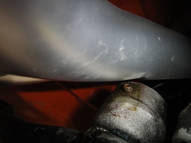

My experience was passenger side... like butter! No problems at all. Driver's side, test fit, beat with hammer, test fit, beat with hammer, and repeat until clearance of the steering is complete. :)

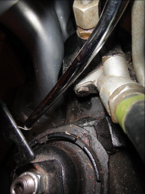

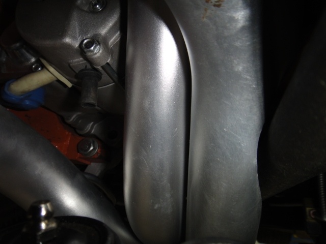

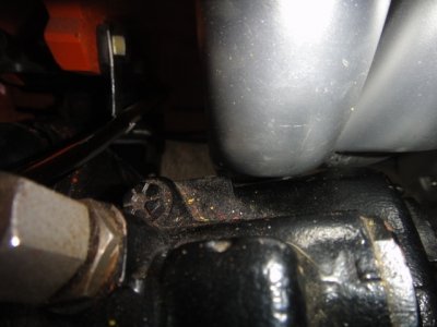

Right side wasn't bad, just a little ding for the fast ratio arm. Left side was a nightmare. In and out 20 to 30 times. Dinged for starter (mini), torsion bar, steering column and the very worst, the power steering box. Buy TTI !!!!!!!!!!!!!
DSC01265.JPG DSC01268.JPG DSC01271.JPG DSC01269.JPG DSC01274.JPG DSC01253.JPG DSC01252.JPG DSC01254.JPG DSC01260.JPG View attachment 392867
