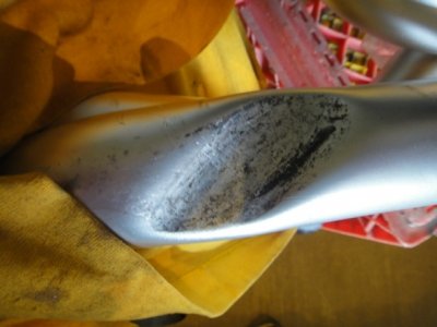

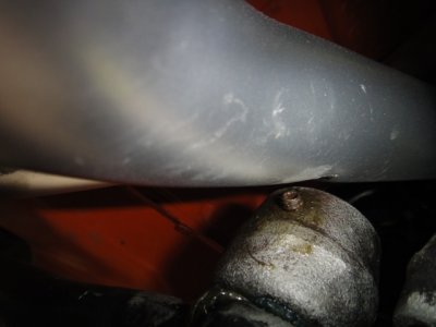

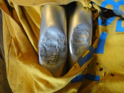

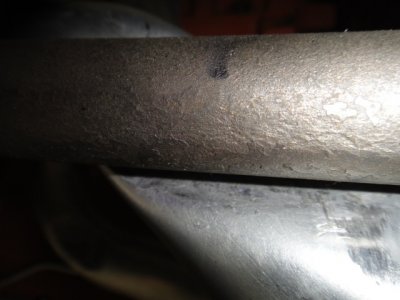

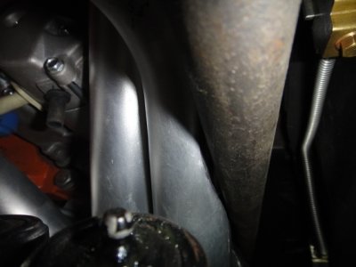

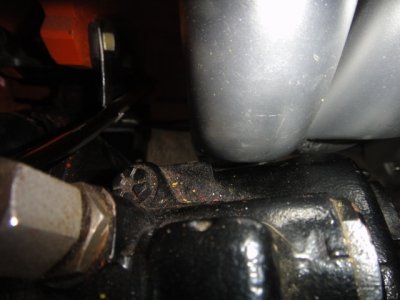

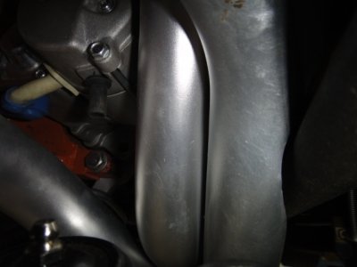

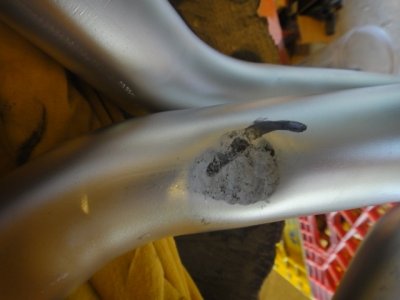

My experience was passenger side... like butter! No problems at all. Driver's side, test fit, beat with hammer, test fit, beat with hammer, and repeat until clearance of the steering is complete. :)

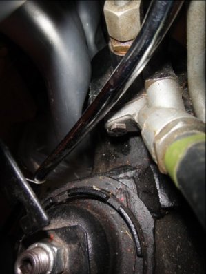

Right side wasn't bad, just a little ding for the fast ratio arm. Left side was a nightmare. In and out 20 to 30 times. Dinged for starter (mini), torsion bar, steering column and the very worst, the power steering box. Buy TTI !!!!!!!!!!!!!
