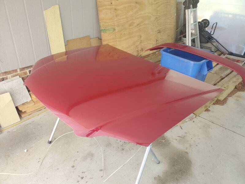

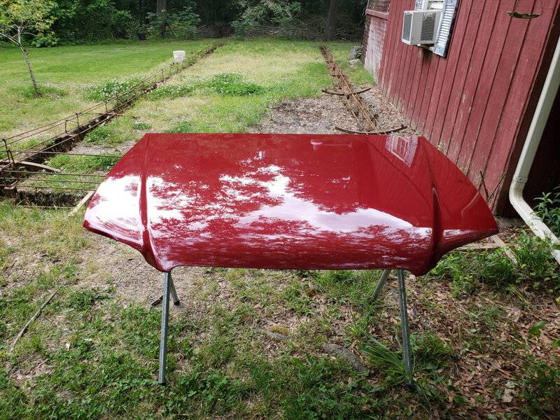

So I started with the hood . . . took it down to primer, shot the base coat, and then the clear - yes, in my backyard . . . everything looked great . . .
until I came back 10 minutes later and saw all the bugs in the paint ! ! ! ARGH . . .
So on to plan B . . . set up a paint booth . . . in my carport . . . put plastic up . . .

Hood repaint 2.0 . . . and spoiler repaint too . . .

The finished product - when my painting was completed (including my typical couple of runs in the clear coat) . . .

Ive had Flys in some of the paintwork Ive done. Doing there death swim. I got a little vaccuum that sucks those little things out of the paint. There legs sometimes stay.

Nice job. I usually have a small set of tweezers nearby when painting. I usually need them for a bug or two.

Wish it "was" a bug or two . . . more like a bug or 20 . . . Just my luck !
