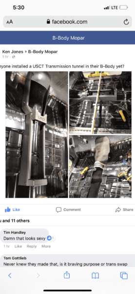

US car tool makes a badass trans tunnel as well. Tempting...
