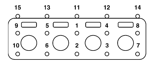

I am replacing the heads and head bolts on a spare Gen3 5.7. What is the procedure for head bolt installation? Wet? Dry? Sealant? Torquing?

OEM from dealer: M12 BOLTS=25,40 FT/LBS, +90º, M8 BOLTS=15, 25 FT/LBS
