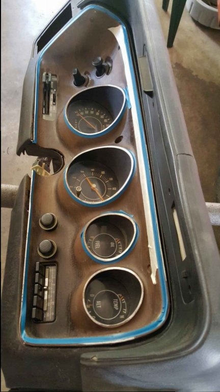

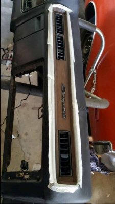

Removed dash. Was missing air ducts. Acquired them from here :). Replaced the cut up gauge bezel. And replaced a few broken vents. Also picked up the proper dash emblem from eBay . Installed a factory AM/FM radio. Also replaced dash harness. I'm in the process of making a speaker bracket for the dash so I can use two speakers. Still have a ways to go before the dash assembly is completed.

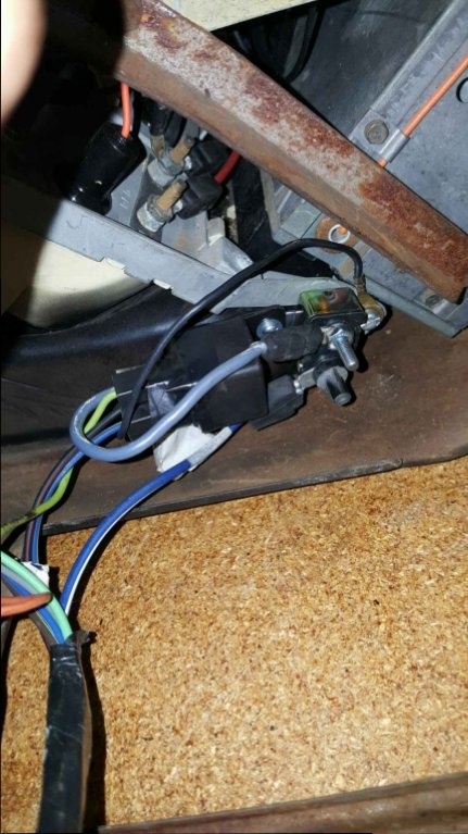

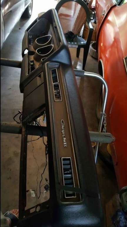

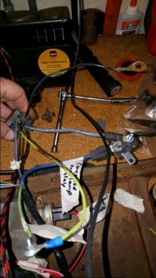

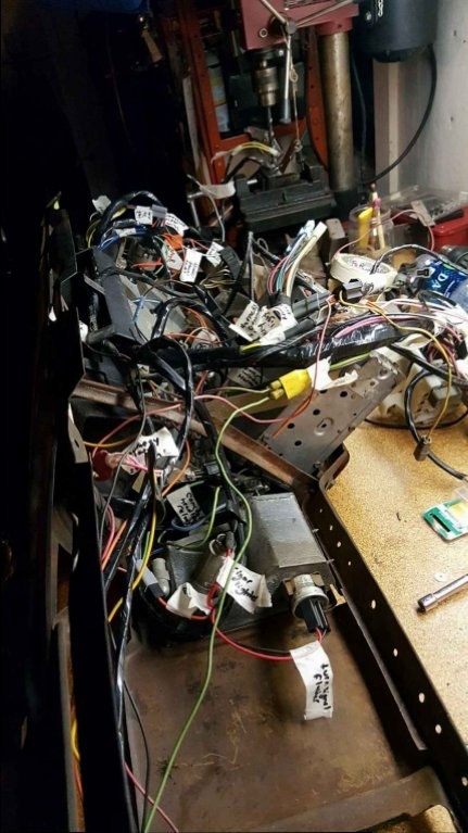

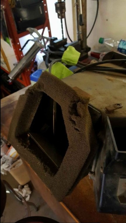

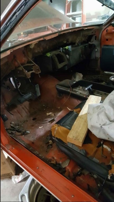

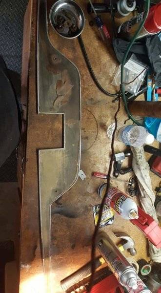

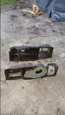

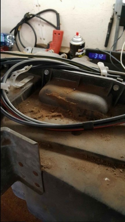

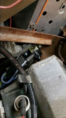

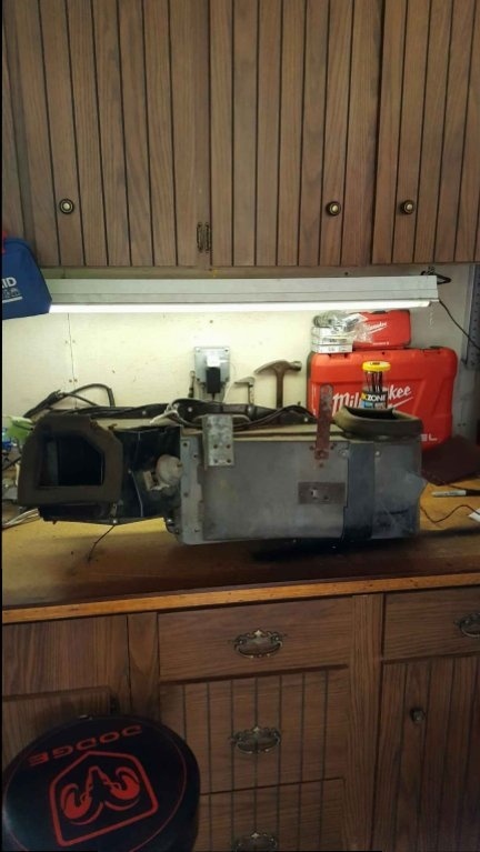

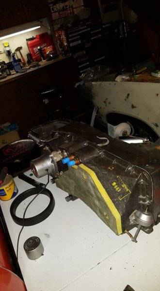

Hey everyone. It's been a while since I've workwd on this car. Life gets in the way sometimes. Here's an update on what I have done since my last posts: I have removed the dash assembly and the ac/heater box assembly. I've gotten the dash rewired, anded a overlay to the pad. (Sorry guys poor man here). I did use M&H wires and labeled everything, so the next time I need to work on it, it will be much more simple. I have a new heater core on order as of this post and already have the Detroit Muscle foam repair kit. No clue on where all that foam goes as to mine was disinterested or ate by mice. Also this foam has no sticky. So what to use that wont chemically eat the foam? Anyways, I took a bunch of photo's. Enjoy.
0_20160909_123954.jpg 0_20160907_024614.jpg 0_20160918_103906.jpg 0_20160918_112914.jpg 0_20160906_233042.jpg 0_20160906_233059.jpg 0_20160907_023439.jpg 0_20160907_024242.jpg 0_20160918_151225.jpg

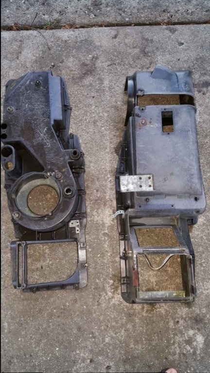

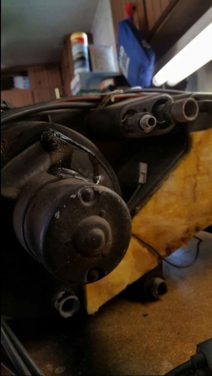

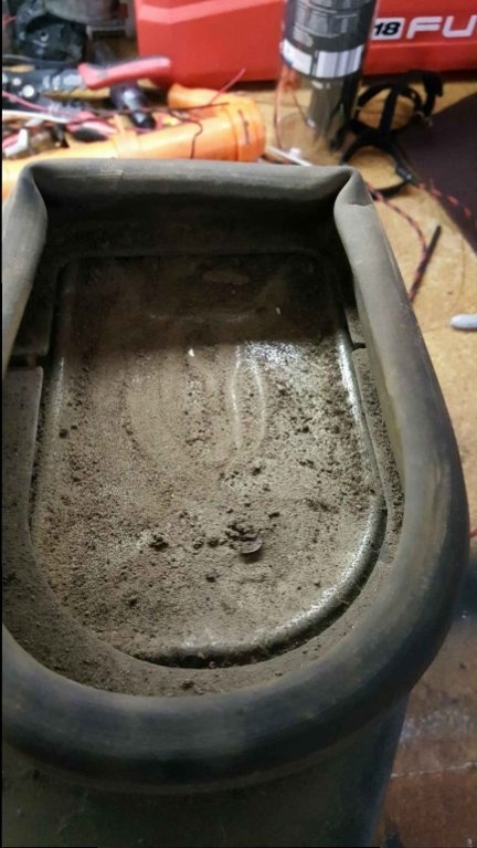

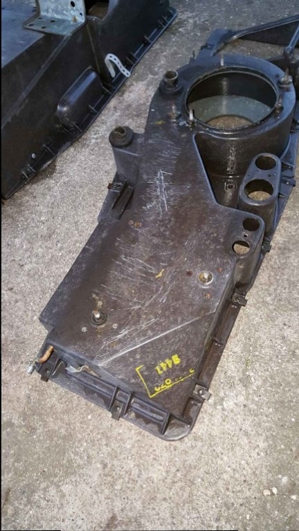

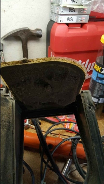

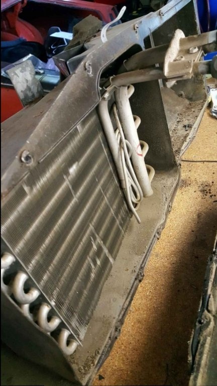

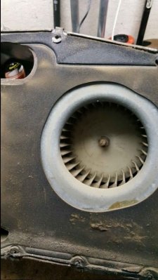

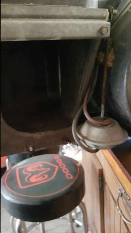

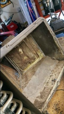

Funny reading my last post from 2013. I can't find that damn emblem anywhere. So im using the se one for now. Here's the rest of the ac/heater box tear down.

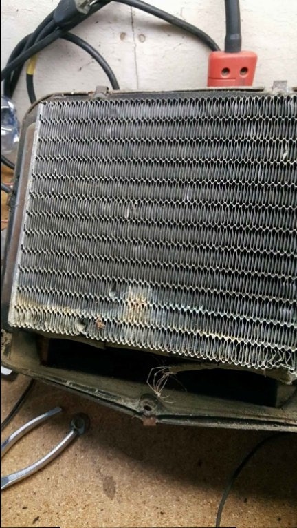

0_20160918_151258.jpg 0_20160918_151231.jpg 0_20160918_151234.jpg 0_20160918_151238.jpg 0_20160918_151251.jpg 0_20160918_160100.jpg 0_20160918_160108.jpg 0_20160918_160121.jpg 0_20160918_160112.jpg 0_20160918_160133.jpg
I can upload 10 pictures at a time. Here's some of it scrubbed down and clean. Also the picture of the ticket was inside of the box. A friend on Facebook found out the years the drive through was in business. 64 -82. So I was impressed it was still in there.

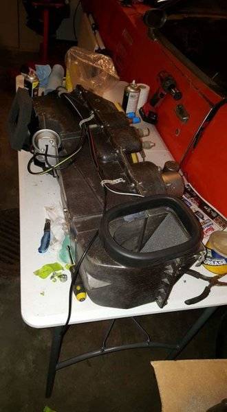

It's been quite a while since I've added to my story. I finished up the heater box.

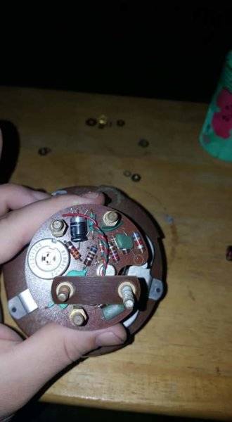

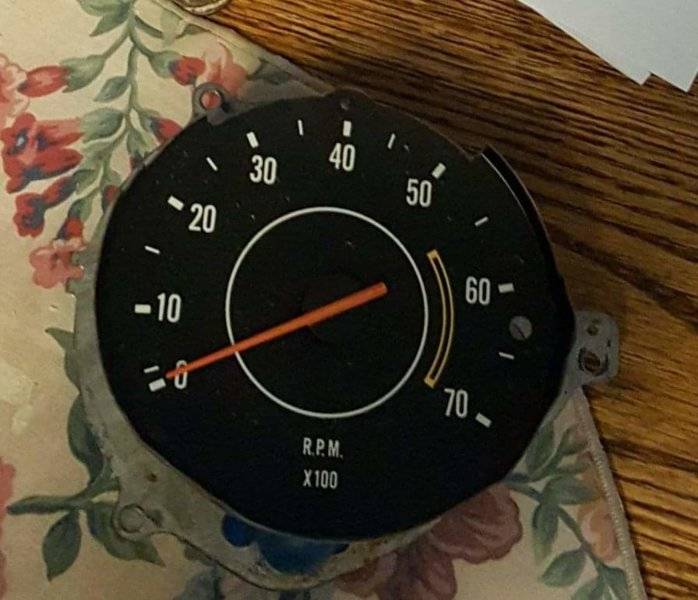

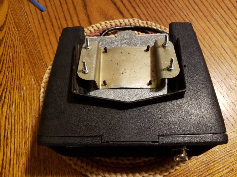

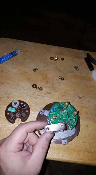

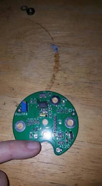

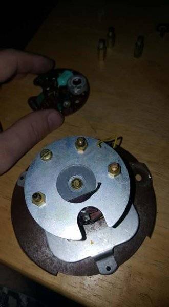

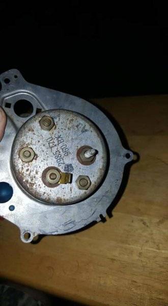

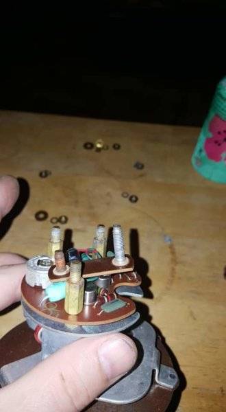

I got lucky and found a original tach on Ebay that was being sold as a Cordoba tach. I researched the part number and it was for 71-74 b body's. I upgraded the circuit board with a RT Engineering's board. And calibrated it using the instructions. It was very straightforward. Even for a dope like me.

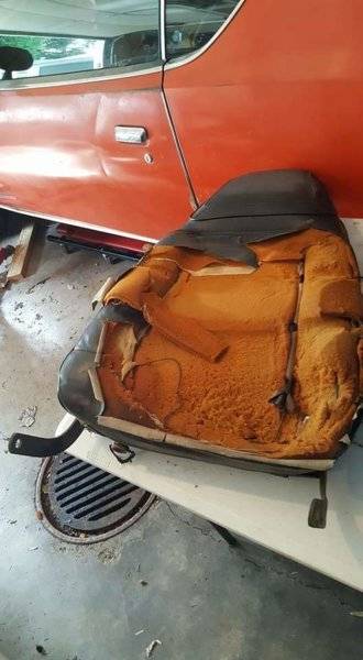

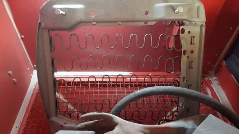

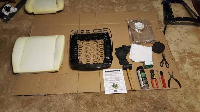

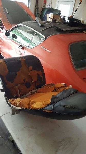

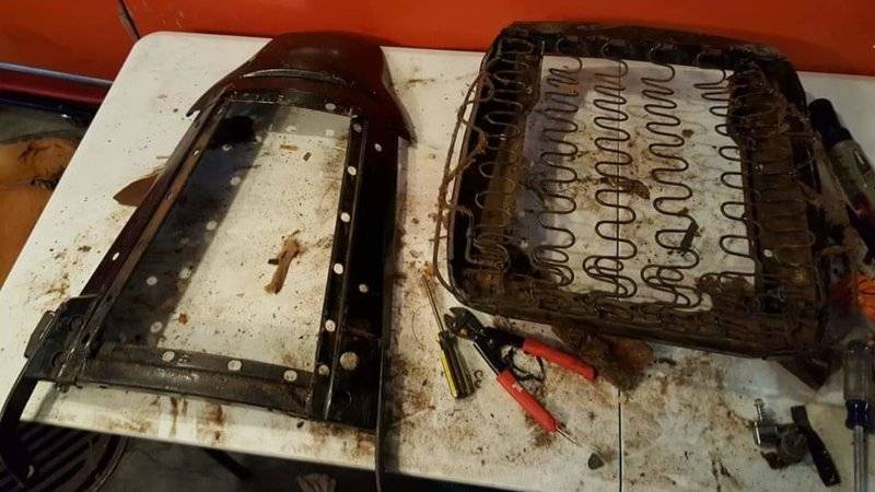

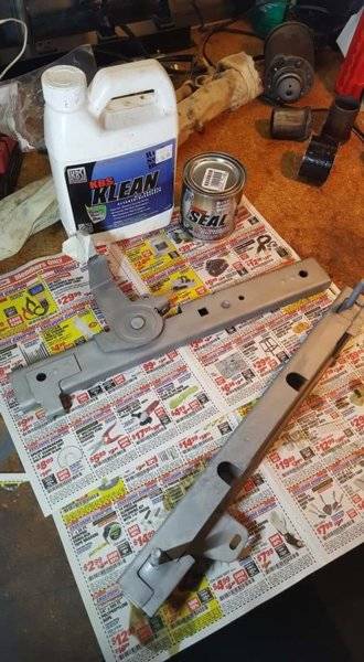

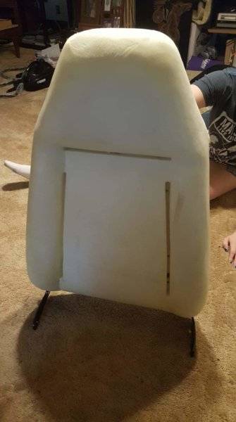

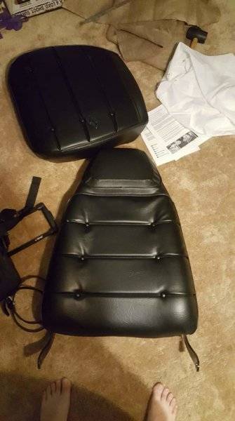

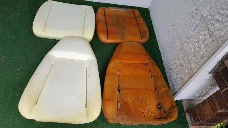

I did some interior work as well. Last year I stripped the driver's seat, blasted, fixed, powder coated the frame, and installed legendary covers with a new foam kit.

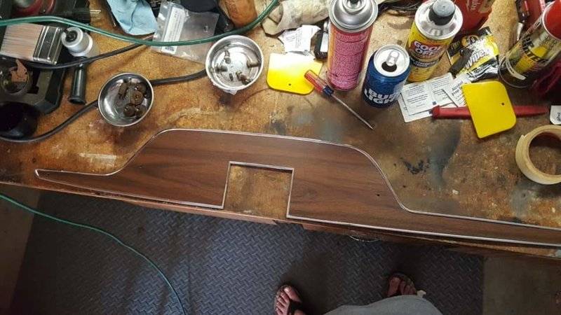

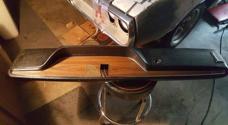

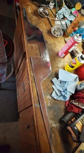

I then cleaned up the center console , scraped off the old insert, and applied a new insert .

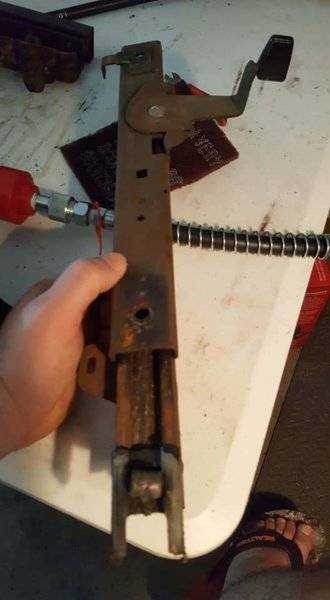

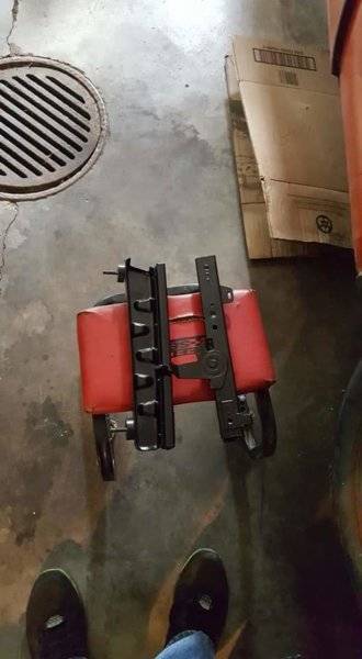

After watching a video on YouTube, I restored my seat track for the driver's seat.

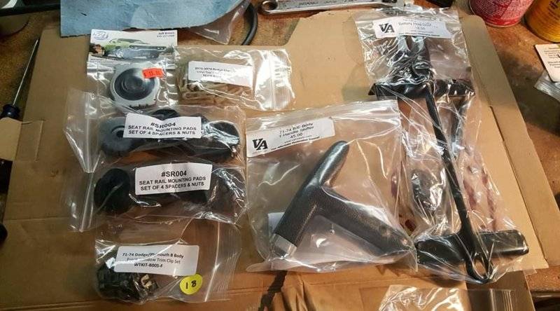

I got some goodies from Mopar Nationals 2018.

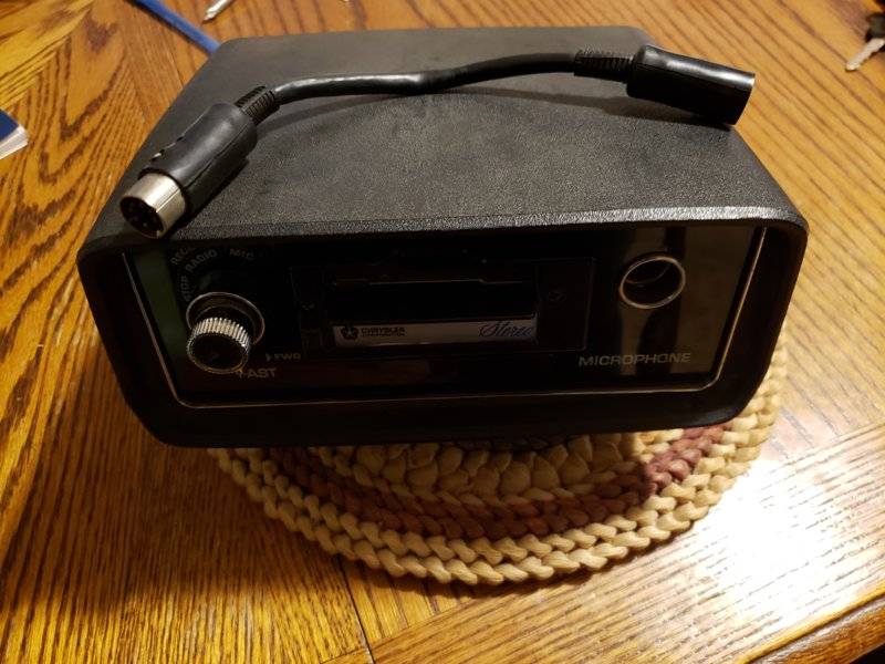

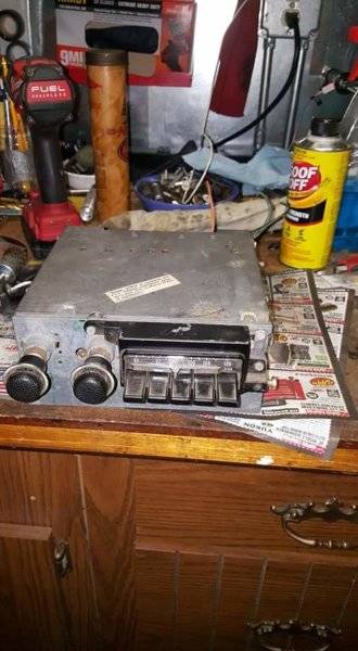

I decided that I wanted to add the multiplex radio and found one on Ebay. After giving up on Ebay for an original cassette recorder (crackhead prices)for a console, I reached out on Facebook. A gentleman p.m.ed me and a deal was struck. So now all I need is the microphone.
Nice to see you back and all the progress, good job on the heater box. I've got the DMT kit staring at me but haven't gained the courage to start working on it yet. My box does have some cracks and chunks missing. :(
