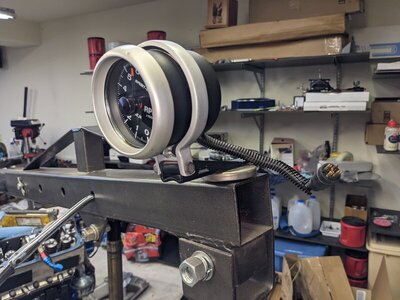

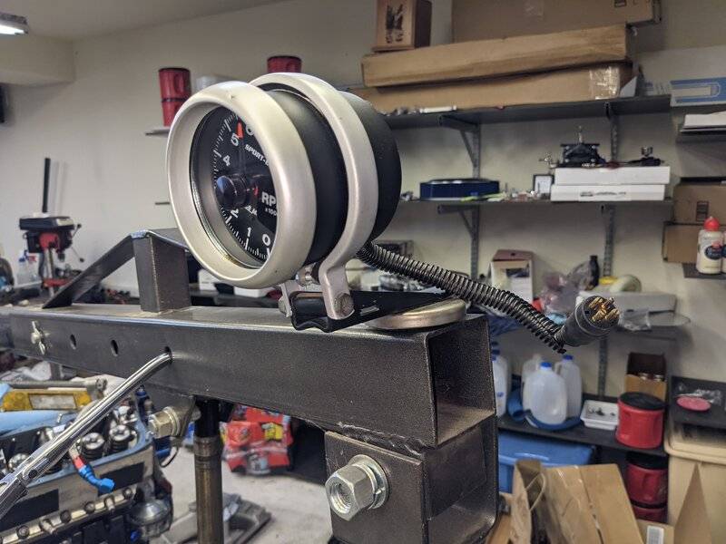

A great alternative to screwing gauges into the lower dash is to buy some really strong Neodymium magnets and mount the gauges to the magnets. They can then be stuck to the dash with no additional holes necessary. I use this concept for my tachometer.
