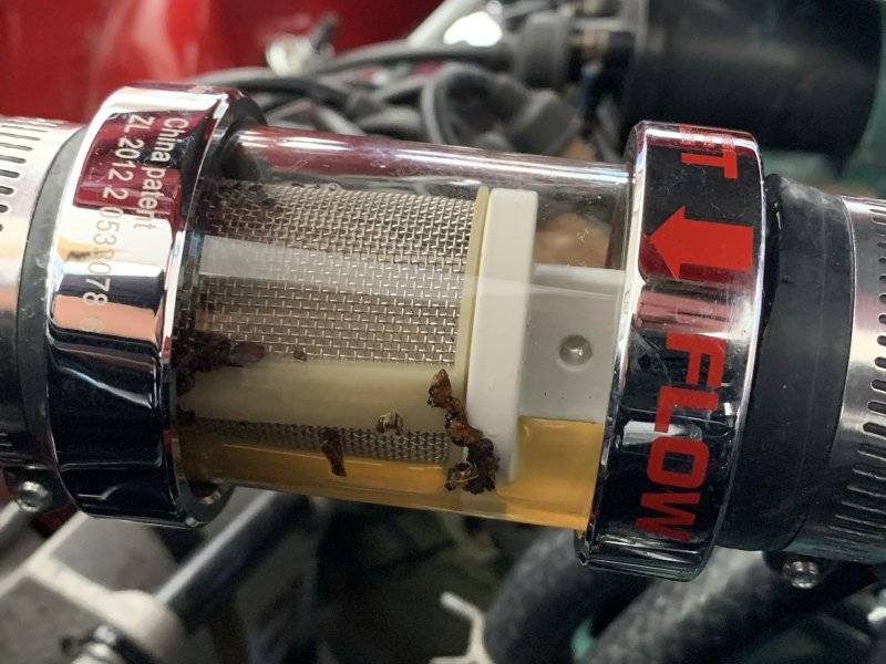

PS - when I’m not showing the car, I replace my upper hose and use this filter, I’m still getting debris and rust on a regular basis from the block.
