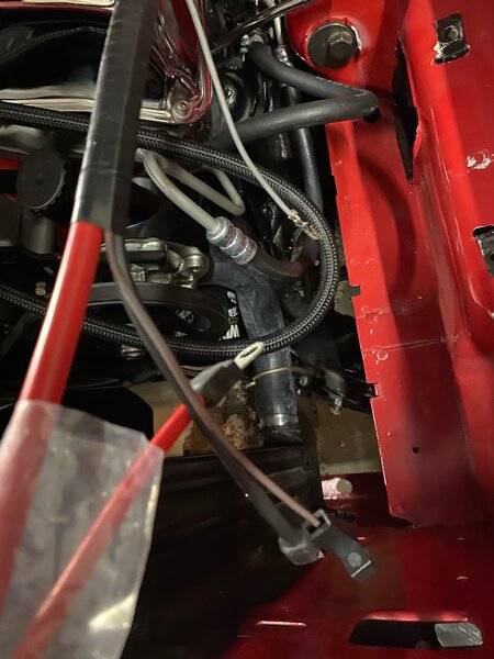

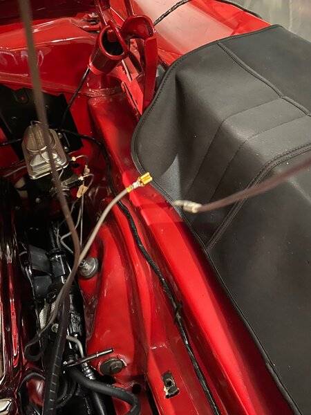

hi guys a bought a hemi post battery cable from Mancini.
I'm a little confused with the wires. I have hooked not up to the starter no problems.
im guess one end of the gray and brown wire go to the starter relay but I'm not sure where the other ends of these wires go.
Also the second smaller red wire im guess goes to the starter relay I'm just not sure why its so short?
and lastly I have no clue where that black wire goes with the funny plug on it?
Looks like you have A 67-70 b-body. Looks like you have the wrong cable because the starter relay wires are at the rear of the battery. Which is where a 70-71 e body has it, and a 71 B body.
Before we get any further Maybe tell us your car Year and trans type, and what cable you bought. The hemi cables are very specific to the car and year.
