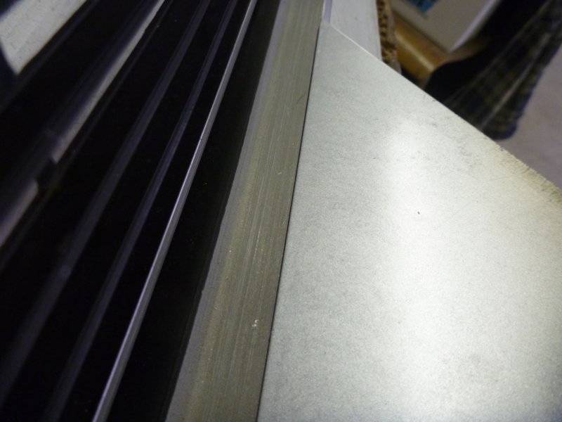

I honestly don't know if this silver is supposed to be textured or not. @dadsbee found some Duplicolor that was a close match, but I doubt that had any texture in it. I can't find the stuff he used around me to find out.
I started with an untouched OE grill and matched to it the best I could. This is the best shot I can find, holding a test piece up to it that is way to bright... there was no texture on the grill I used. And as to what I used... take the C off the start of the product number and you may have better luck. The C is for Canadian..
