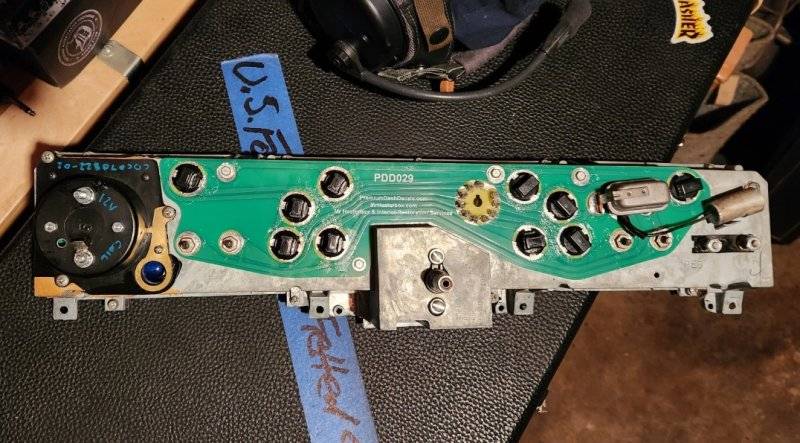

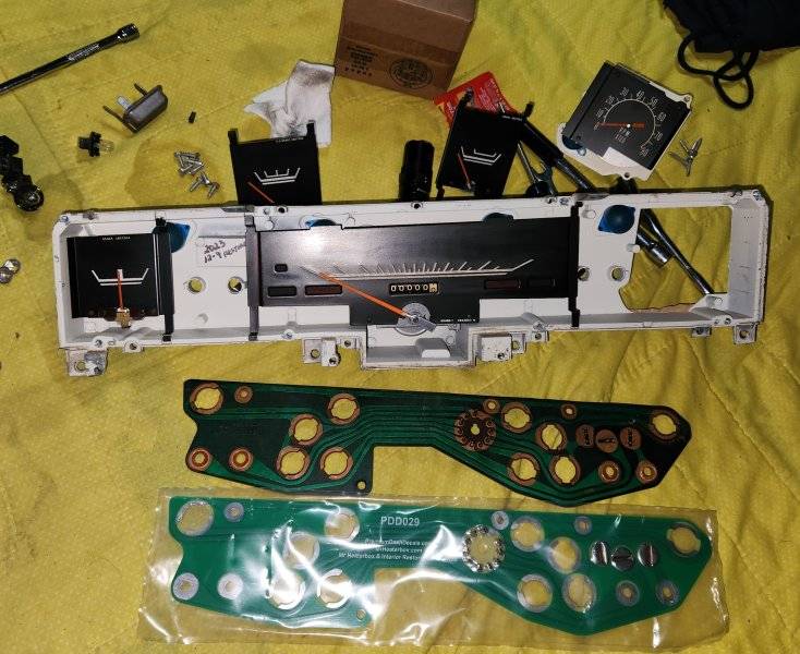

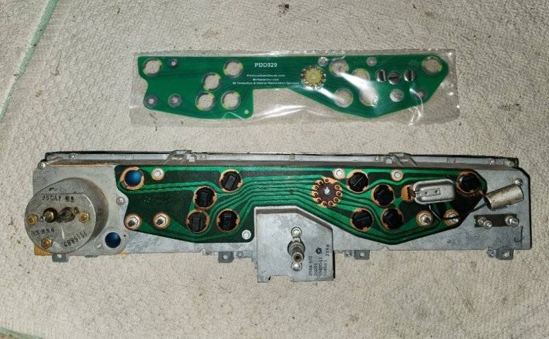

Circuit Board on back of cluster needs replaced, look for "Mr Heaterbox" or B Body circuit board on E Bay. CAN be a Pain in the *** the 1st time. But that's how we learn. I dunno if yours is Rallye or Non-Rallye, taking switch bezel out is a little weird. DISCONNECT battery first!
Don’t think it was circuit board….

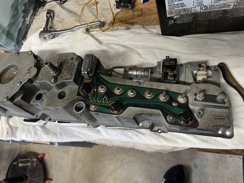

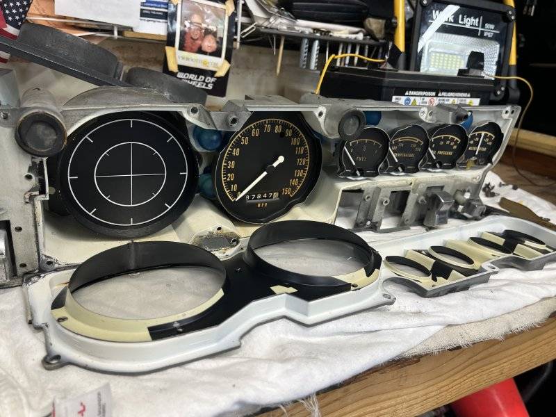

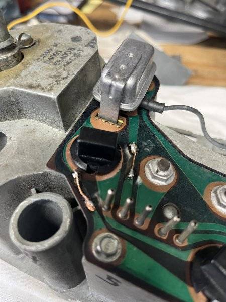

Everything worked after contacts were cleaned up inside steering wheel. I’ve already taken my rallye cluster apart for upgrading and cleaning… even repaired 2 of the ribbon circuits
