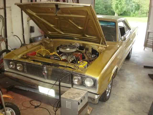

I also just looked at your engine picture... What are you doing for crankcase ventilation? I couldn't really see much from the picture. Also, is the vacuum advance now hooked up?
Is it me or does that carb not look like a 750 Holley? more like an old eddy or carter? wonder if he changed the points and has the vacuum connected? I like those headers TTI? nice and snug. Craig you say you have the msd box but you have the old distrib?
Hahah I apologize bigmanjbmopar, its an old picture JUST when I put the engine in the first time, forgot that I had that edelbrock on there!!!
