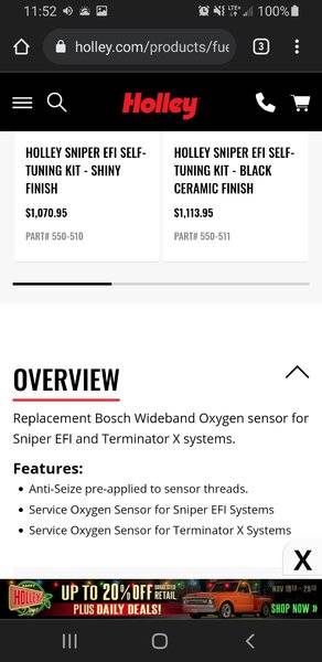

I have to get one I see like numbered o2 sensors but not sure they are the same. So Im going to have to buck up and pay for the Holley version at 119.00 for a 40 dollar part lol.

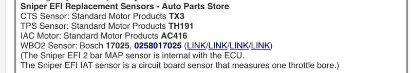

Bosch 17025 is what is recommended on the forums as a replacement. I very seriously doubt Holley manufacturers any o2 sensors. Even their website says it is a Bosch brand.

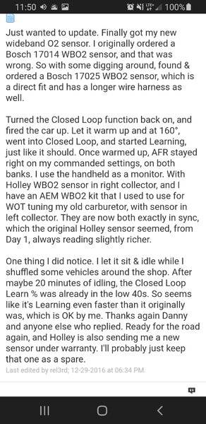

Installed the new Bosch O2 sensor and fired it up and its running great again. AFR is at 13.5% Im a little worried though I was looking at the IAC and its saying 20% I tried adjusting it as the video says but that's the lowest number I could get out of it. But I also just started a brand new tune so that may have something to do with it.
