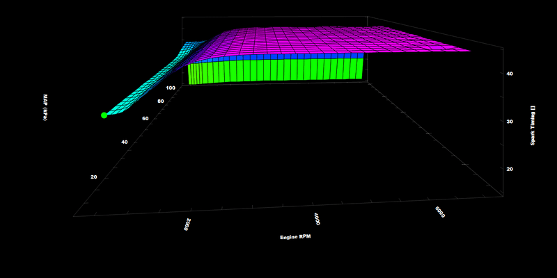

So I shut it down and save the tune to the sdcard. I bring that into the house and stick it in the computer and open the sniper software. Start looking at the ignition graph and wow WTF its running 32 degrees of timing and I dont understand why if I set it at 15. The graph looks horrible. Maybe hopefully someone here can tell me wtf I'm doing wrong here. I also downloaded the Terminator X software to look at some global configs there and the ignition on lets say a GM big block is more aligned to what I would expect out of the base timings for the sniper. Here is screen shot of the graph on the sniper timing starting at 32.1 Why would it be so different from one to the other. There is something terribly wrong with the curve set by the Hyperspark.

I dont know anything about the EFI/Hyperspark setup, but if it's actually idling at 32 degrees, i would think it would be damn near impossible to start. So, that's gotta be some of level of mis-information, no?? Like that graph is just wrong, and the timing is really more like 15???
I checked the actual timing with my light and Yes it was running 15 degrees. But I think its adding fuel as if its at 32 degrees. THats why its loading up. Does that make sense? I just can't make sense of the tables they have set for the timing. It goes by 3 items to determine the timing. Map kPa, RPM and spark timing. I have ordered an Orange box which is why I went with the Hyperspark in the first place because the orange box took a dump. So I'm going to go back to the old style ignition to see if its something in the hyperpark that went wonky.

OK for **** and giggles I just reloaded the SD card from the Holley site with a completely fresh set of files. Im going to go install the card and use the stock cam file. I just double checked it with the sniper software and it looks to be normal. 15 down low and 36 up high. So makes me wonder how in the hell the 32 got in there? I will come back with my findings.
This is the base tune timing from the fresh install of the card contents.
This was the one that was on the card prior.
