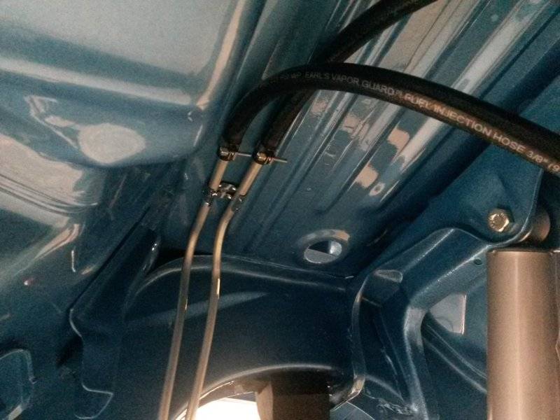

    We did a '70 Charger with a Sniper. We used 2 3/8" reproduction steel lines and modified them to fit. Used Earls Vapor Guard EFI hose.

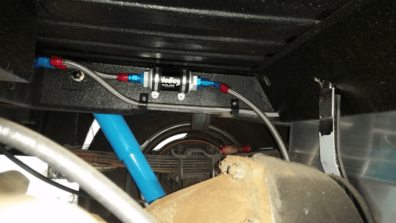

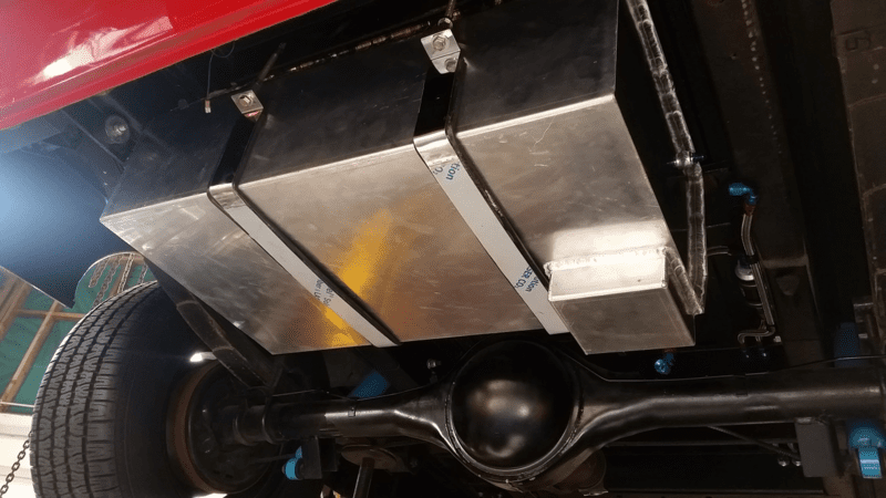

      I have a Holley Sniper atop a 408 from BluePrint Engines in my Dodge A100. Loving the way this engine runs....so much better than a tired carb on a tired engine. Tank was custom made locally due to freight and time constraints. Used Earls AN fittings, SS braided hose, and a couple of specialty bulkhead extension tubes for the chassis rail for a finish that is hidden under the bed floor. I didn't have a lot of faith in 58lbs pressure with just rubber hose and barb fittings....besides our Tech Inspectors would question those also I suspect.
