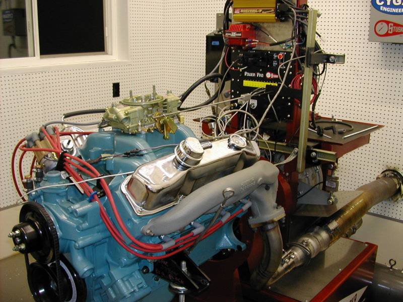

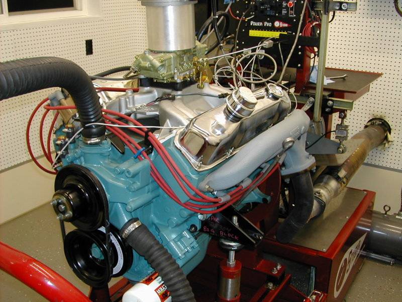

I have dyno tested a 6 bbl, Indy 2D and a Holley SD on a 508 with manifolds. The carb was a small venturi 950.
Key Dyno Learnings:
1) 6 bbl made the least peak power
2) The SD made the most peak power.
3) Despite the 508 cu. in and the conventional wisdom that "the Holley SD is just as good as a dual plane down low" was not the case my testing. It was not until 4000 to 4500 rpm did the Holley SD catch up to the two dual plane intakes in power output.
4) Modifying the Indy 2D plenum divider got it to just about the same peak power as the SD, but it was still better than the SD below 4000.
My opinions based on my dyno testing results:
1) The power difference between the three was not that large and 95% of the people would be please with any of them, and would never know the difference.
2) If you spent more time trying to extract more power from any intake, you can probably find some gains.
I don't remember any idle difference between the three.
I would expect the Eddy RPM to perform similar to the 6 BBL.
You can get the RPM to work under your hood, but you may, or may not get the factory air cleaner to work.
Now you need to take this information to Dwayne, let him square it up with my cam verses your cam, and your goals, and then go with his recommendation. But again, you will not be killing this motor with which ever decision you make.
