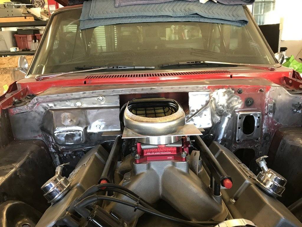

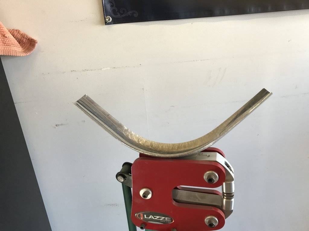

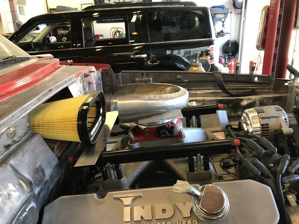

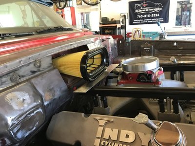

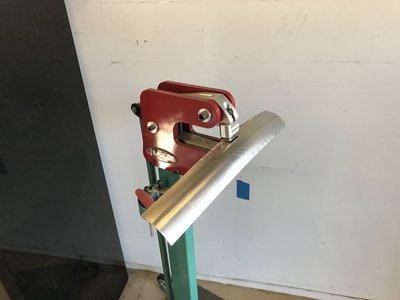

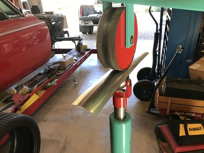

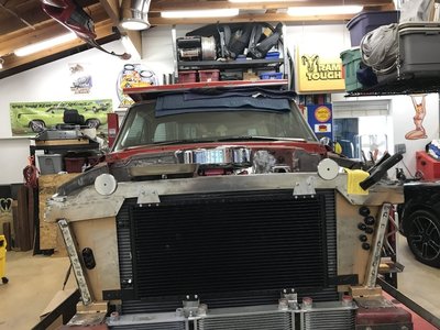

I picked up a 16" sealed unit to modify and use as a NASCAR style cowl induction on my 65. After I slipped the engine/trans back in for more mock up, I see that the unit is going to be too tall. I don't want to cut my flat hood. Back to the drawing board. What I came up with is make a unit from scratch using the spacer ring, needed it to clear the rails and tb arm of the FAST tb, as the base. Started making a plenum that will have a base to attach the filter and outer section with spring clips off an OE a/f unit. The outer portion will be attached at the firewall to the opening I made. I ended up with a filter for a 14- Vette, with blower although n/a and blown use the same one. I was thinking of using an element for my 04 Cummins but its too big to fit there unless I modify the rails. Wanted a filter that would have enough surface area so flow is not restricted. The first part of the t/b unit I made up on my Lazze english wheel then used my Lazze shrinker/stretcher to curve it around. This weekend I'll continue filling in the blanks.
