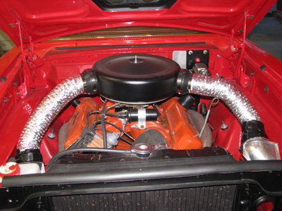

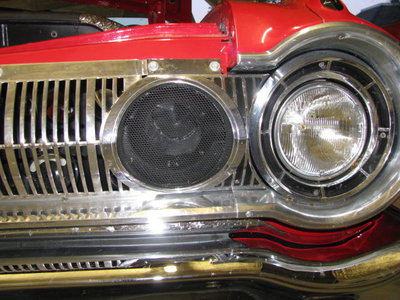

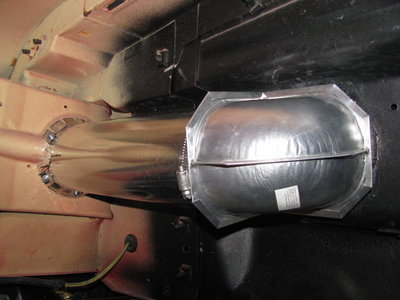

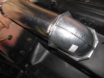

I have been working on fresh air induction for ole Brutus--1964 Dodge ...ala Ford Thunderbolt
These pics are pretty crude, just first mock-up. No, I won't be using "gorrilla" tape ! 8-) .....Since these pics, I have lowered the air cleaner and might have clearance for 4" tubing. ...............MO
IMG_0059.JPG IMG_0060.JPG IMG_0061.JPG IMG_0062.JPG IMG_0063.JPG IMG_0064.JPG

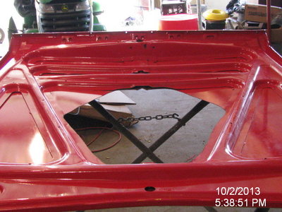

Well, my cowl induction plan didn't work. I bought a Ram Air Box from AIS and it sat up so high it would have taken a 6-8" high rise to cover it.

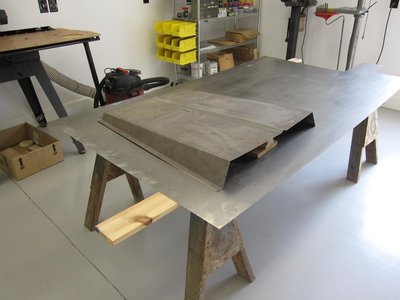

I went to the only option left-a scoop. I will not choke down my engine and that includes feeding it underhood air. I designed and laid out a scoop using my original hood (reinforcements rotted at rear).
Here are some photos of the roughed out scoop:
Mike
More photos. I talked with my body man and we decided to glue the scoop on with corner welds!
Mike

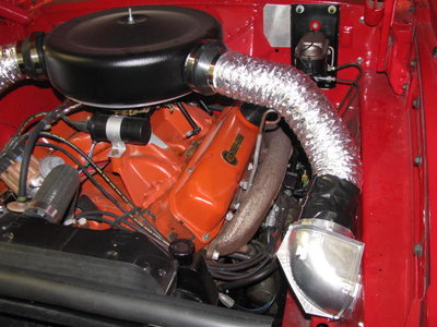

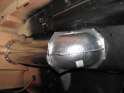

Mike, Nice work on your hood scoop. I especially like the front edge. The 1964 Dodge is much easier with the inner bracing the way they are. I didn't have to cut any of it out, and with the air box I used and the "butt ugly" hood scoop, it finally worked out pretty well in the end. I am using the flat base ( offset cause the engine is not centered in the hood) on the air cleaner so that it's easier to get to carb adjustments I did have to go from a 2" phenolic carb spacer to a 1" to make room for the air intake hoses. BTW check out Spectre flexible duct plastic like hose that uses "threaded" on connectors . A little pricey , but well worth the trouble it saves. Easy to form and re-form and hold its shape. I will attempt to attach a pic...Good Luck !......................MO
