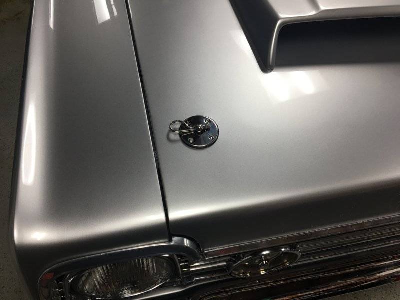

I ordered a set of reproduction 70 B Body hood pins from Dante's Mopar hope they get here by Friday.
Done. Used reproduction Hood pins for a 70 B with the rubber gaskets underneath.

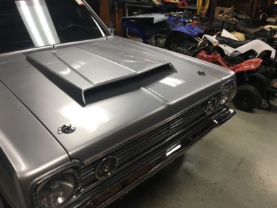

You're going to need 2 right in front between the 2 you have there. That front end will want to lift right off the car and tear that stock latch off the fiberglass.
I have them, factory installed. My hood latch has never ever popped open accidentally, but I have great peace of mind with the hood pins.

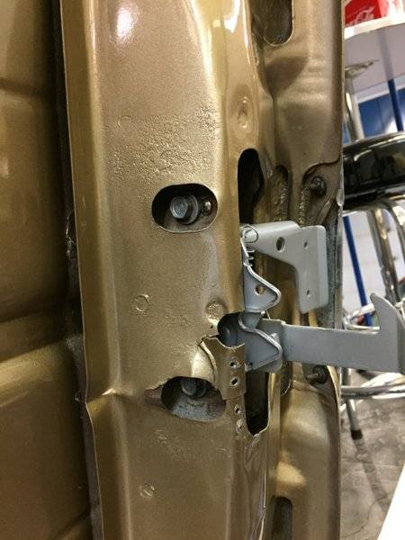

I used to run my stock steel hood with a hemi scoop and no hood pins. I didn't want to drill into the hood. It ended up that that the inner brace cracked and started to pull down. I used some plumbers strapping after I noticed but that tore the next pass and I nearly lost the hood. I could put my entire hand in between the hood and the inner structure, which the latch bolts to. I was lucky.
I fixed the inner structure and drilled pin holes. I learnt my lesson on hood pins.
It had opened up 4 inches after the pass.
