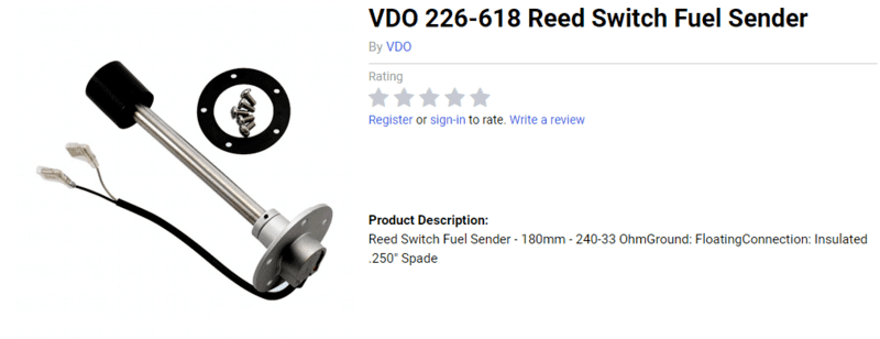

The fuel cell that came in this car has a two pole sending unit in the tank. It says it comes with a 0-90 ohm sending unit. How do I connect that up to the one wire from the original harness and is a 0 to 90 ohm sending unit going to work ?
Do you mean a 2-wire sender unit - like a VDO sender?
If so, the blue wire goes to the original wire from your gauge, and the black wire can be connected to the chassis at a convenient location....make sure all your connections are solid, tight, and insulated where appropriate.
