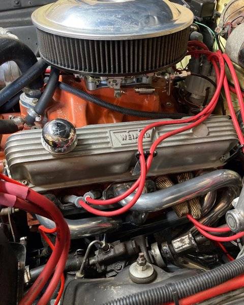

Some MSD straight plugs can be bent quite a bit. They call them "Multi-Angle" boots. I don't know if that is what you have, but if it is, you might be able to gain a little clearance with a little creative bending. I did that to gain a little clearance for the header on my 360. I also added a couple of heat boots. I have put about 500-600 miles on the car with the set up pictured and the boots still look like new (I pulled them off this past weekend to change sparkplugs).
yes i know of them my problem is they tend to be close on the tip connector i was going to try hedder plugs and ceramic plug wires
