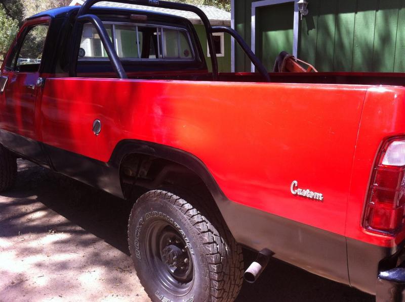

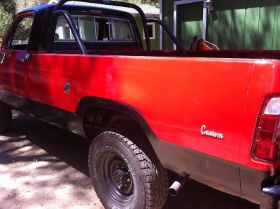

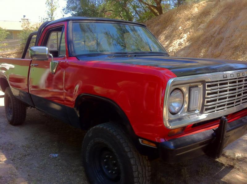

Man is that a sharp truck, love it! I'm with you on the annoyance factor but to me it's more of an embarrassment than anything else. I'm going to assume the pickup suggestion is meaning checking the gap to the reluctor wheel? I've seen them pretty far out of wack and it only takes a few minutes to check.

Love the look of that truck by the way! Looking forward to seeing your 500 at Spring Fling *** and hopefully the autocross on Thursday.
