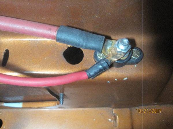

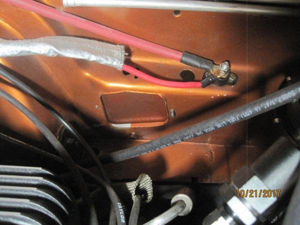

I think the cause of the high resistance is right here:
The 1/0 terminates at the distribution post, from there is a brand new OEM + batt cable to the starter, wrapped in DEI heat shield. I haven't done a voltage drop test at the starter because it's just about impossible to connect any leads with the hot headers in the way. I didn't attach the 1/0 directly to the starter at the time of engine install because the cable size was too large to fit the starter terminal. In hindsight, should've found a way.
I took 2* out of the distributor, down to 16*. Now the other issue is that the FiTech has to relearn the new timing. The 2* hasn't seemed to help.
I've searched E bay, Summit, various Mopar sites for a pair of offset starter terminals; haven't found any. Can someone direct me where to find a pair.
My new plan: find offset terminals, connect the 1/0 direct to starter; jumper wire to starter solenoid. Please offer up any more comments and suggestions; the car is on the road strictly because of the help from fellow FBBO members.

There was a vendor here that sells (Mini Starter Conversion Terminals). His handle is Valiantone. He sells them on forAbodiesonly also. The add was posted here on 6/29/17 in the MoparParts&CarsMarketplace/Mechanical parts. If I knew how I would send you a link to the post that mentioned it. I want to order them also as I had/have a similar problem. I mentioned this in a post years ago and it was mentioned that my mini starter expands and binds up from the header heat. when it cools, no more problem. I wrapped my headers near the starter and it helped but still an issue but now I plan for it. I bought a starter wrap also but headers too darn close to put it over the starter. Good Luck!
A little wrap on the header near the starter.
also a wrap on the starter itself will help. I run more initial timing than that, (21) w/ the stock cable ran to the starter from the factory solenoid, a 2/0 welding cable from the rear mounted battery to the solenoid, no problems in the heat, w/ way more engine than u stated. I had a ford solenoid on it for a while ,but it gave up. I didn`t have a neutral starter switch w/ it either.
By the way, your ability to wrap the starter and / or header depends somewhat on what brand starter and style of header you are running. Mine are almost touching each other. Next time around I am going for TTI Tri-Y headers. They open up accessibility considerably.
Exactly; I know other guys that have smaller cable than 1/0 and don't have the hot start issues. Another reason why I'm ditching the distribution post and going directly to the starter.
The heat soak into the cable to starter is a very common trouble spot with headers.
