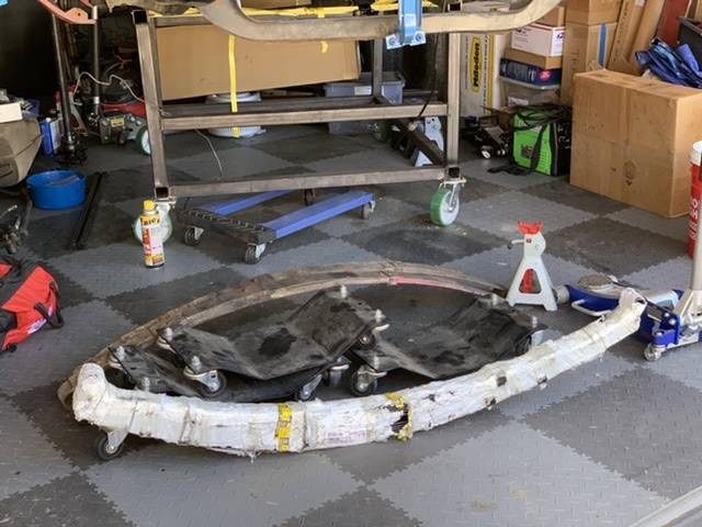

The company was easy to work with, and Lauren kept me updated on the back order issues. She helped me with what I would and wouldn’t need. Got them, and they look fantastic! The paint is powder coated and perfect! Those ones in the back are my old ones.
