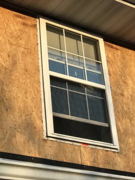

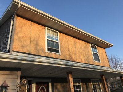

Anyways going to install some new vertical siding on the second story
I was a little surprised when I pulled off my faded horizontal vinyl siding on our 20 year old home here in WI , built in 1999 , and discovered no house wrap , maybe it wasn’t code required back then ?
Obviously flanged vinyl windows already installed
Wood sheathing is excellent along with windows - Zero moisture damage anywhere , everything looks great honestly
Should I install house wrap or just leave it as is ?
If I install house wrap , everything I see online is pretty much done BEFORE windows are installed as far as flashing , tape etc.
Am I overthinking this ? Or how to use flashing tape etc and bring the house wrap up to and seal around the windows
Top of windows are basically just under soffit overhang by about 4"
Thanx for any advice

You should try to get something under the bottom flange of the window (which shouldn't be nailed). I'd also extend the side flange with 3m All Weather Flashing Tape extending that over whatever you use for house wrap. *** backwards, but unless you want to pull the windows...which you should consider as it's pretty easy. Just cut the trim/caulk away from the inside first.
I think the basic question here concerns flashing the windows without pulling them out.
Wrapping before the window installation is better but not a deal breaker.
For sure wrap the house in Tyvek. Cut it around the windows then flash tape those seams with the best **** you can find.
Didn’t really want to pull the windows
I could pull the nails on the bottom flange however

3m Flashing tape extended - Thanx

Wrap is fine as is.use the 6" window tape, available at most home improvement stores, install the bottom tape first then the sides, followed by the header. Prevents water creep at the corners.
So do this first with the 6" window flashing tape on the window vinyl flanges to bare wood sheathing
Then Tyvek the whole second story with wifes help and hope she doesn’t fall off the roof or gets
Cut out window openings
And tape again in same manner around the windows with the Tyvek seam tape or 6" window flashing tape in same manner

I would do a 6" butyl rubber / foil flash around the window to sheathing in the fashion Pushrod stated, wrap, then foil tape the wrap in the same fashion.
Bottom up on all layers so the the water runs over, out and down.
